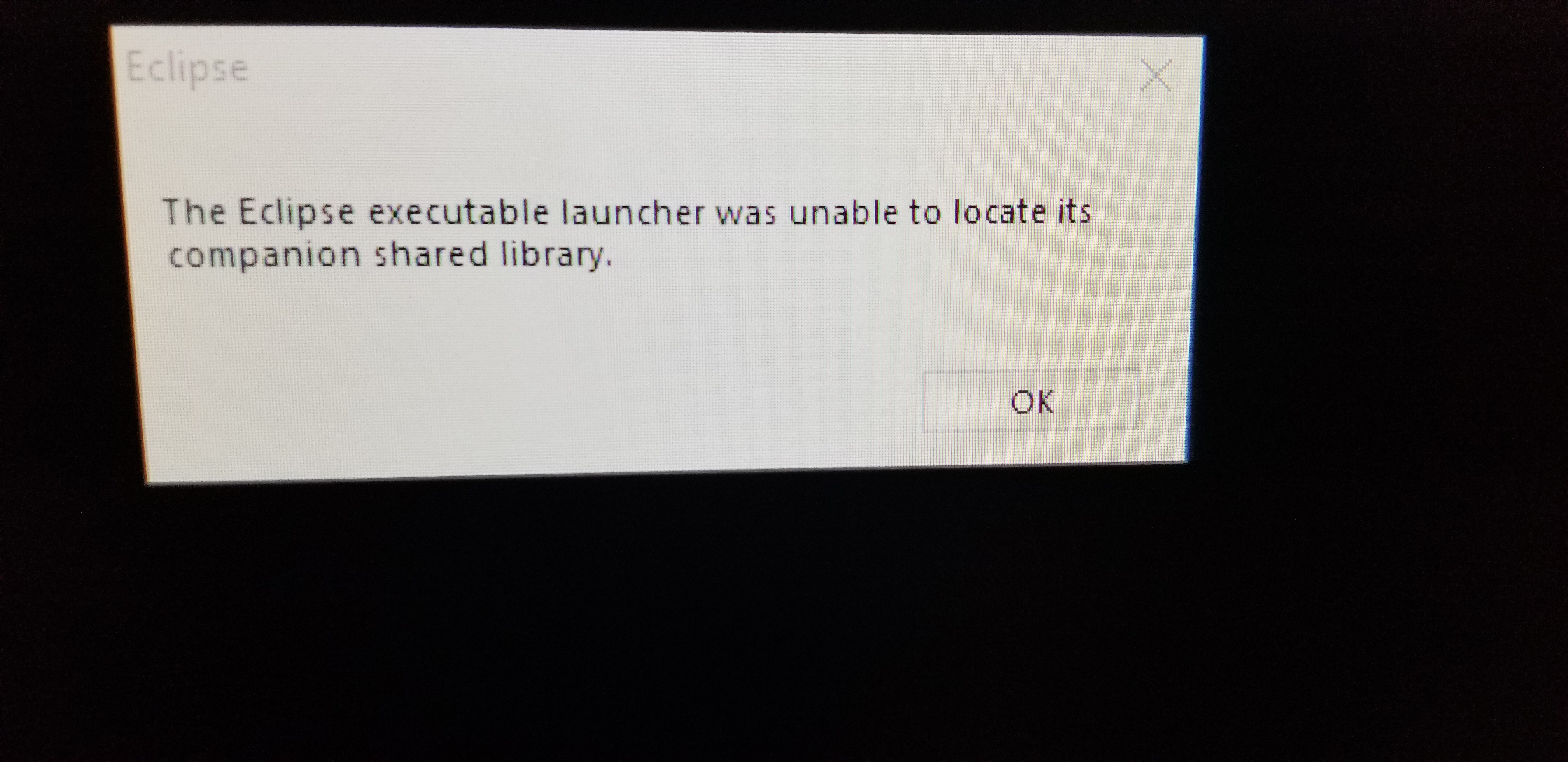

I've been trying to install Eclipse for Java Developers on some lab computers for the county school system work in IT for. Once installed under a domain admin account it will launch fine. But when any other user tries to launch it with their standard domain account they get the message: "The Eclipse executable launcher was unable to locate its companion shared library"
I have installed as a local admin, my domain admin account, and edited the properties for the shortcuts like I see recommended. I have spent about 6 hours total on this and have reached the end of the road. I've gone into the Eclipse directory properties security tab and granted full permissions to both all local users and all domain users. Still nada.

Did you install using the installer or by unpacking a packaged download?
If you used the installer, read the information (available via the installer's menu, Ask a Question), about the bundle pool.
https://www.eclipse.org/setups/installer/question/
I.e., either you should disable the shared bundle pool or you should ensure its folder is visible and read-only. The installation folder itself should also be visible and read-only.

An exe option was the only option I recall being given. After installing a box comes up with sever components you can choose. I chose the Java for Developers option and checked the box to Install for All Users. The shortcut appears on the desktops for different users that log in, but they get the error message I attached.
Is there a different way I should be installing on PCs that have multiple different domain users logging in with domain rights?

Currently working as IT Support for a University. Downloaded Eclipse in the admin domain account. Imaged it to all the other PCs. However, Eclipse isn't available in the student accounts. Tried many things, including the exact same things you listed, yet no answer.
Eclipse is being downloaded into the Local disk, but isn't accessible to the students for some reason (as it pops up the same error message that you've shared in that screenshot).

I recently had a similar problem when trying to distribute the previously configured eclipse (with additional installed Software) for Users.
I am no professional here whatsoever so it was more of a try and error, but what worked in the end was to edit the "eclipse.ini":
Within the "eclipse.ini" were 2 entries with wrong repositories.
1)
--launcher.library
D:\[PATH]
2)
-startup
D:\[PATH]
Since editing didn't help, I simply removed those 4 lines. And tried to launch "eclipse.exe" again. This fixed the problem in my case. Afterwards eclipse had adjusted these entries on its own.

For me Worked when try below steps:
Delete the unzipped eclipse folder then
& moved Ecipse zip from Download folder to C drive & try to unzipped then clicks on Eclipse exe it worked.
my eclipse version : Version: 2024-06 (4.32.0)
on Windows 11
