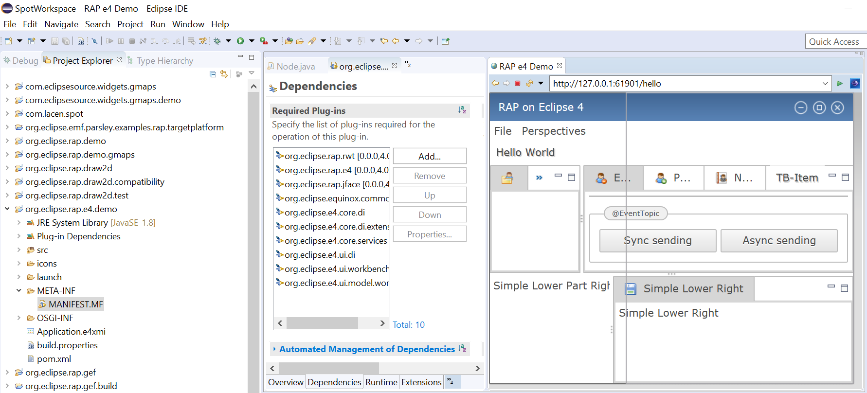

Pbs using e4 and org.eclipse.rap.ui. In this case the icons are not visible!!!!
To reproduce the pb it's very simple:
1- Download the project org.eclipse.rap.e4.demo from here:
2- Run it you can see the icons for the different parts and items.
So the result is:
index.php/fa/37284/0/

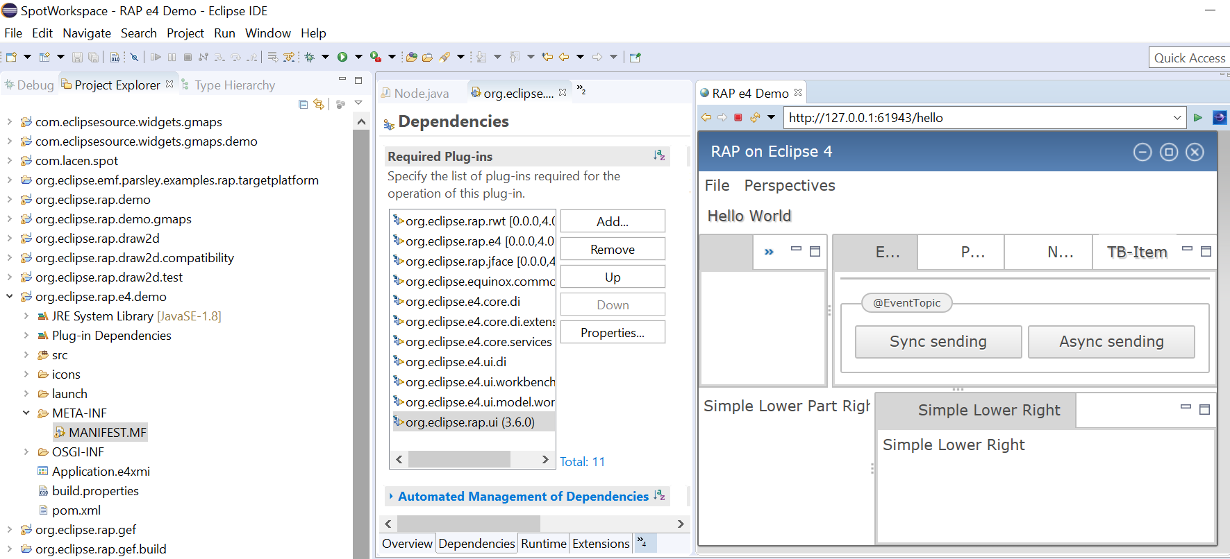

3-Add the bundle org.eclipse.rap.ui (this bundle need also org.eclipse.rap.ui.workbench) using the run configuration tool.
4-Run again the project: The icons disappear!!!!
The result is:
index.php/fa/37283/0/
Why? Have you an idea how we can solve the problem?
Why to add these bundles? Because to use GEF in a e4 application you need to add the bundle org.eclipse.rap.ui, and in this case there is no more icons......
Thanks a lot for your help.
Re: RAP e4 + rap.ui [message #1821068 is a reply to message #1821038] Wed, 05 February 2020 02:03 Go to previous message
you should not mixed bundles from e4 and e3 target. RAP explicitly provides target platforms for different workbench models.
Ivan
