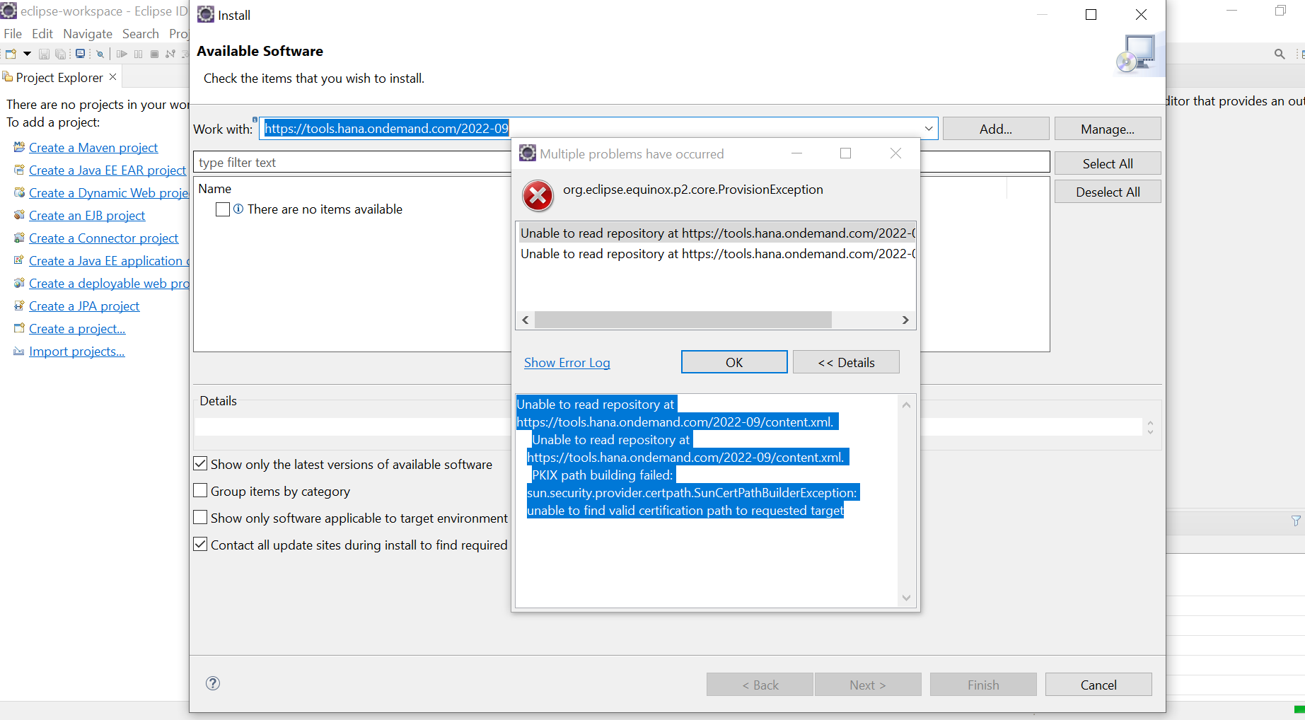

Re: unable to find valid certification path to requested target [message #1856283 is a reply to message #1833459] Wed, 30 November 2022 22:53 Go to previous messageGo to next message
Hi Team,
I am also getting the same error. Can someone please help me.
I have installed Eclipse 2022-09 version (both Java Developer and EE/Java Developers) and when I am trying to install the New software, I am getting below error.
