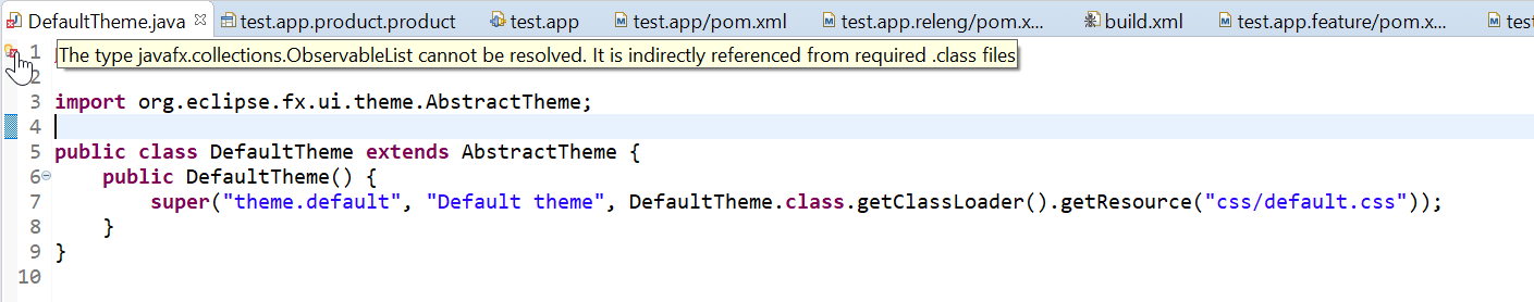

Apart from the other problem I am having with my e4 application and java11, I am having a problem simply getting the default e4 application to run.
Even using a fresh (and latest, i.e. "eclipse-jee-2019-12-R-win32-x86_64" eclipse version, the default e4 application project shows errors and doesn't launch.
I changed the preferences, such that "JavaFX" -> "JavaFX 11 + SDK" points to the lib folder of the javafx-sdk (I tried the root folder as well, doesn't change anything), installed e(fx)clipse 3.6.0 via the market place and created a new "JavaFX" -> "OSGI" -> "e4 Application projects".
Then I get the following errors:
AbstractTheme cannot be resolved to a type	DefaultTheme.java	/test.app/src/test/app/themes	line 5	Java Problem
The import org.eclipse.fx cannot be resolved	DefaultTheme.java	/test.app/src/test/app/themes	line 3	Java Problem
Bundle 'org.eclipse.fx.core.databinding' cannot be resolved	MANIFEST.MF	/test.app/META-INF	line 17	Plug-in Problem
Bundle 'org.eclipse.fx.ui.databinding' cannot be resolved	MANIFEST.MF	/test.app/META-INF	line 18	Plug-in Problem
Bundle 'org.eclipse.fx.ui.di' cannot be resolved	MANIFEST.MF	/test.app/META-INF	line 15	Plug-in Problem
Bundle 'org.eclipse.fx.ui.services' cannot be resolved	MANIFEST.MF	/test.app/META-INF	line 24	Plug-in Problem
Bundle 'org.eclipse.fx.ui.theme' cannot be resolved	MANIFEST.MF	/test.app/META-INF	line 14	Plug-in Problem
Bundle 'org.eclipse.fx.ui.workbench.fx' cannot be resolved	MANIFEST.MF	/test.app/META-INF	line 8	Plug-in Problem
'Automatic-Module-Name' header is required to be discoverable as a Java module in a Java modular setup (Java 9 and later)	MANIFEST.MF	/test.app/META-INF	line 1	Plug-in Problem
An entry for test.app/Application.e4xmi is required in bin.includes	build.properties	/test.app	line 1	Plug-in Problem

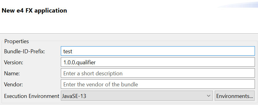

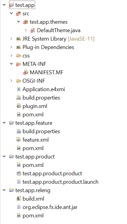

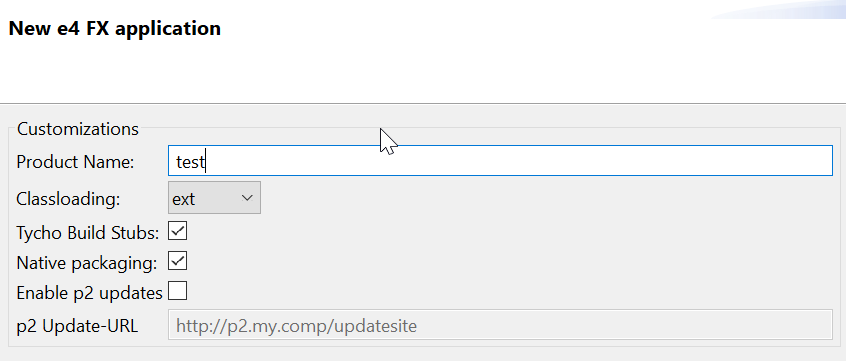

I don't see where I would do that. All I get is four projects (test.app, test.app.feature, test.app.product and test.app.releng). There is no test.app.target project and the wizard does not look like I could have done a lot different.

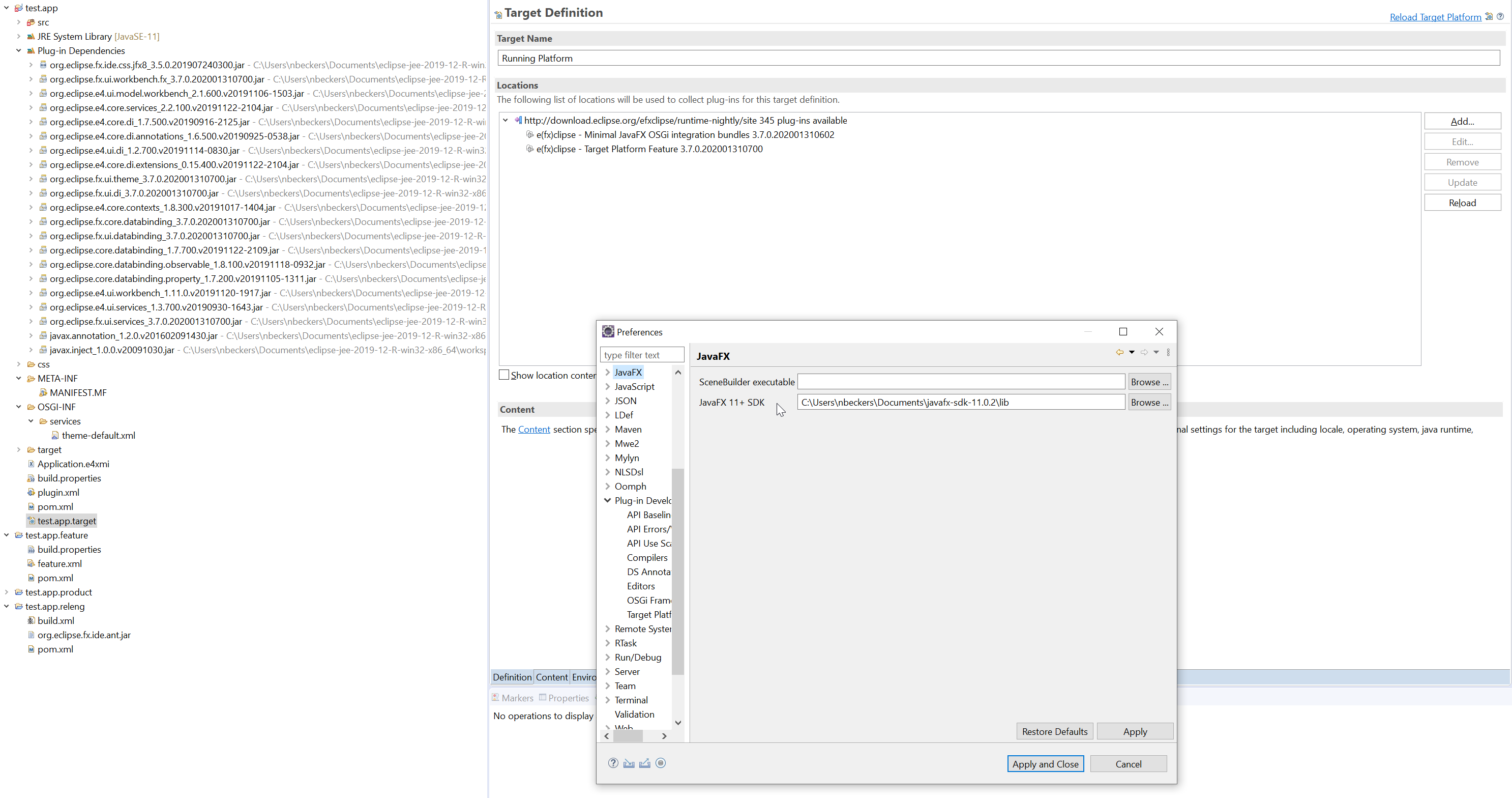

Re: Default e4 application project has errors [message #1820544 is a reply to message #1819550] Wed, 22 January 2020 09:01 Go to previous messageGo to next message
I've now added a target definition, added http://download.eclipse.org/efxclipse/runtime-nightly/site as site and added the "Target Platform Feature".
index.php/fa/37215/0/
This seems to get rid of most of the errors, but there is one final error remaining, which I can't seem to get rid of:
index.php/fa/37216/0/
Adding http://downloads.efxclipse.bestsolution.at/p2-repos/openjfx-11/repository/ to the target definition as well and setting the openjfx features as "Included features" in the features.xml, didn't change anything :(

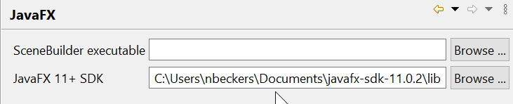

Did you set the JavaFX-SDK in your preferences?
Re: Default e4 application project has errors [message #1820577 is a reply to message #1820556] Thu, 23 January 2020 04:14 Go to previous messageGo to next message
Yeah, it looks like this:
