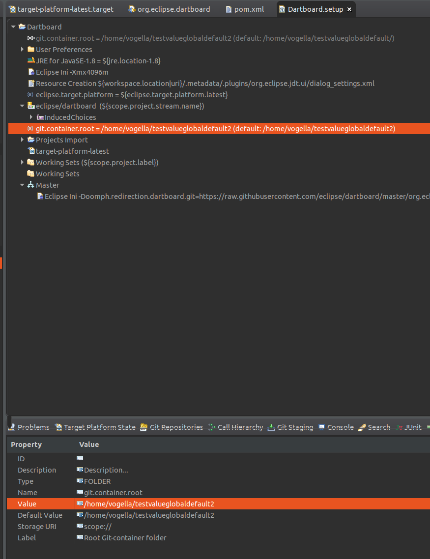

If I set the git.container.root this is currently ignore by the tooling. I tested this like this:
1.) Deleted Oomph configuration in the .eclipse folder via rm -rf org.eclipse.oomph.* to avoid previous choises to interfere
2.) Added git.container.root to both the global entry and the Git entry with the same content as I do not know if a global one will be picked up by the Git task, I guess yes but as it did not work, I tried adding it also to the Git one

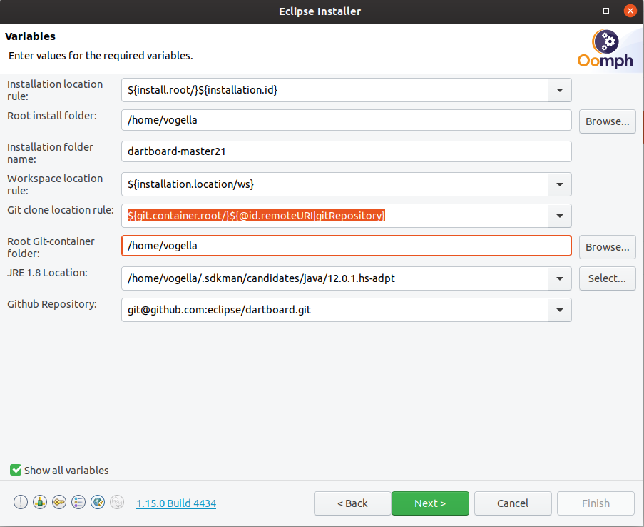

3.) Restarted the installer to get rid of any caching
4.) DnD the Dartboard.setup onto the installer
5.) Check the values on the installer screen after switching the Git clone location rule.
index.php/fa/37130/0/
Anything wrong with my testing?

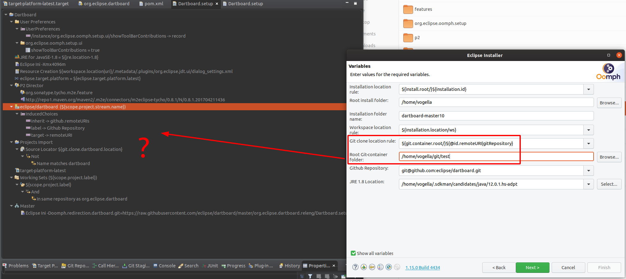

I see a node in "user.setup" containing an attribute node:
index.php/fa/37131/0/
<attributeRule
attributeURI="http://www.eclipse.org/oomph/setup/git/1.0#//GitCloneTask/location"
value="${git.container.root/}${@id.remoteURI|gitRepository}"/>
In the Oomph UI I do not see such an entry. Also the icon does not match anything I see. How can I set this?
