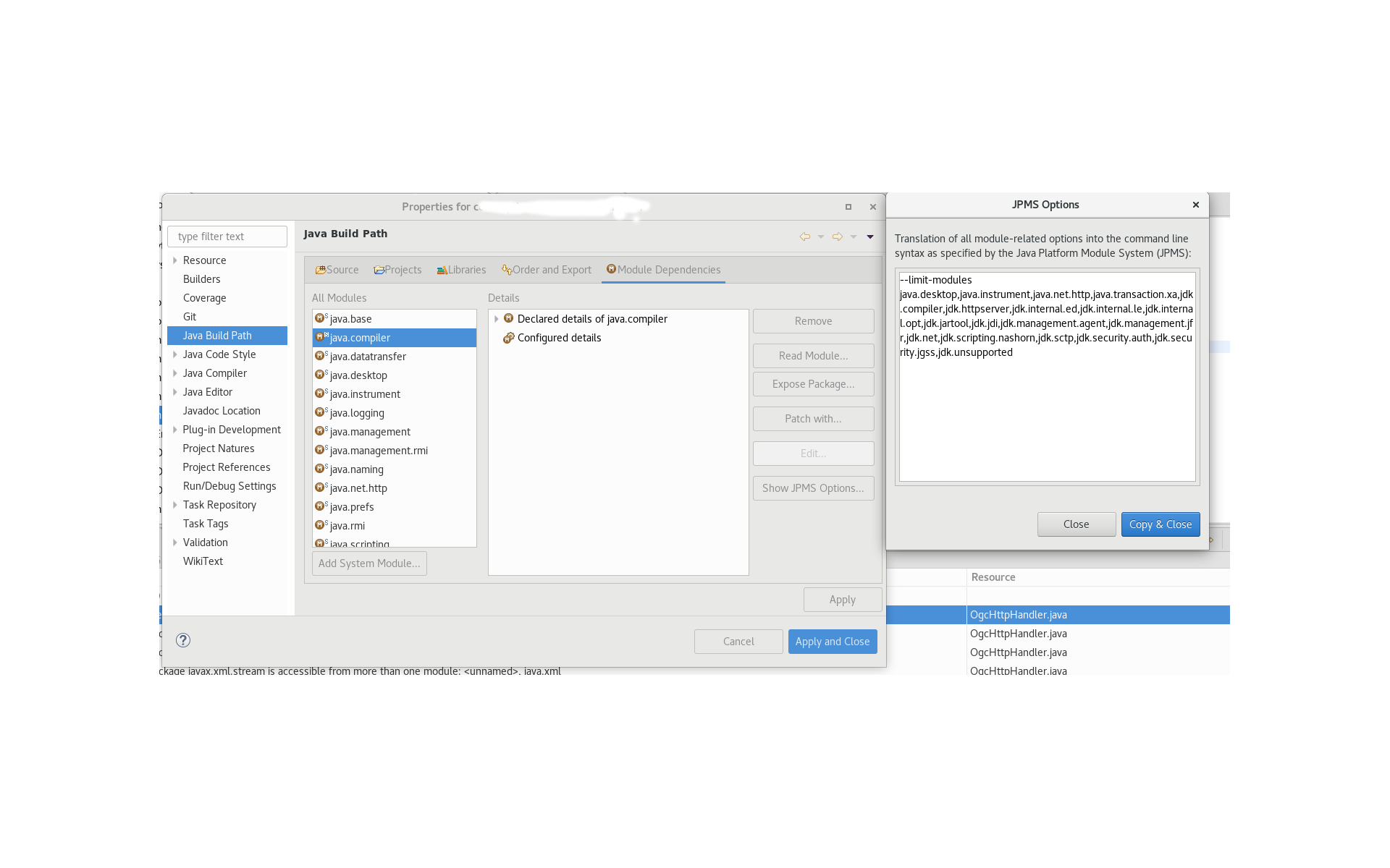

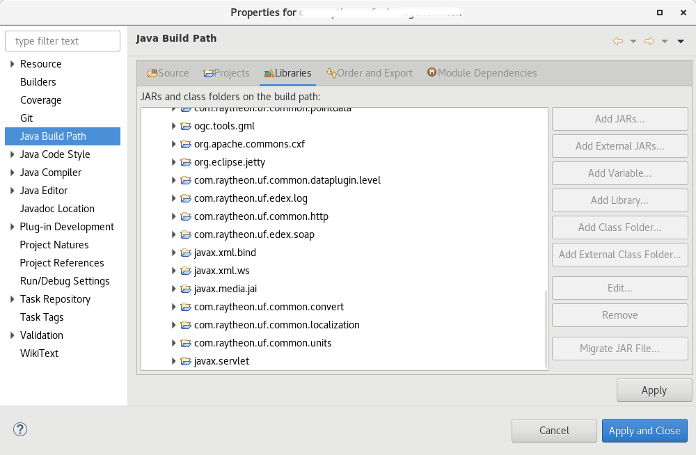

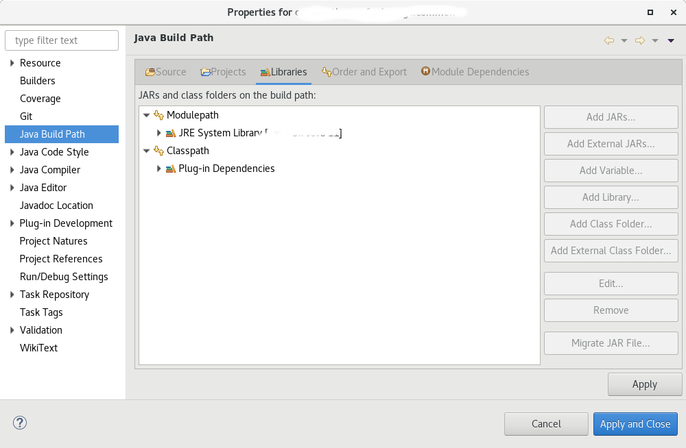

Stephan Herrmann wrote on Sat, 28 December 2019 05:36
java.awt.geom.Rectangle2D is in the system module "java.desktop". Since java.desktop requires "java.xml" you cannot remove the system module java.xml. Instead, you should make sure that no other library in your dependencies provides packages java.xml.*.
By dependencies do you mean the classpath?
Here are some screen shots of my Build Path dialog tabs. I've seen some javax.xml jars in my class path but the button to remove them is greyed out.
[Updated on: Mon, 30 December 2019 11:09] by Moderator
Re: How To "Turn Off" A Plugin And Project Using The "Module Path"? [message #1821106 is a reply to message #1818787] Wed, 05 February 2020 11:33 Go to previous message
I found the redundant jar by using Ctrl Shift T to open the type editor and the searching on that name.
