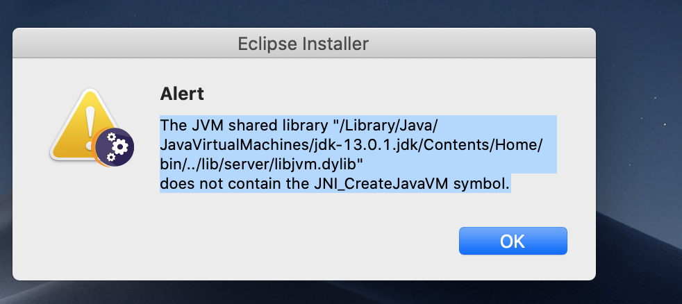

When I try to install Eclipse 2019-12 on MAC OS X 10.15.2 I obtain next message " The JVM shared library "/Library/Java/JavaVirtualMachines/jdk-13.0.1.jdk/Contents/Home/bin/../lib/server/libjvm.dylib"
does not contain the JNI_CreateJavaVM symbol."
Anybody knows what's going on?.

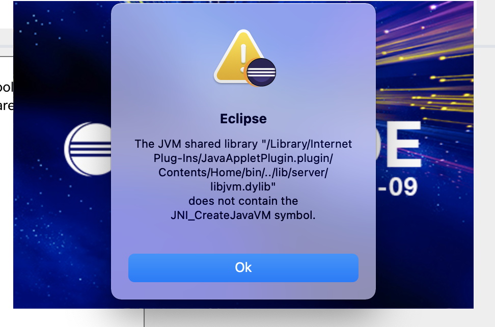

Re: ERROR IN SETUP MAC OS X 10.15.2 [message #1847893 is a reply to message #1847890] Thu, 11 November 2021 12:17 Go to previous message
Now I have the problem with Papyrus RCP I do the installation and shows me the same error, now I have installed the Java 11, any idea??
I include the error in the image below
