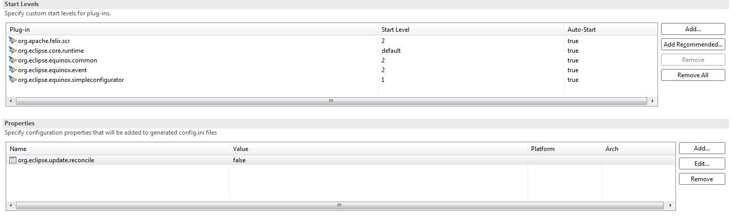

Did you add the recommended plug-in start levels in the 'configuration' tab of the product definition file?
Which version of eclipse are you using? Please provide stack-traces of the errors, from these short descriptions it is very hard to guess what is going on.
Re: Eclipse exported Product file is not working. [message #1817725 is a reply to message #1817719] Thu, 28 November 2019 04:27 Go to previous messageGo to next message
Eclipse version 2019-06 is being used. Earlier we were working on Eclipse Photon but while creating product, Antlr version issue was coming as it was expecting Antlr version 4.3 and Xtext need Antlr version 3.2. Eclipse had both but as a plugin content only one version was accepted. So changed to latest Eclipse version.
I have attached the documents having stack-trace of errors, product configuration and plugin details.

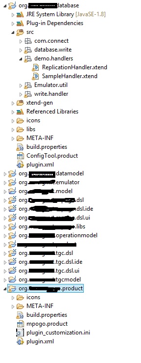

The project org.abc.xyz.database itself is the plugin developed. The demo.handlers.ReplicationHandler class is in that project only. For creating product, a separate product package is created.
The packaged jar of org.abc.xyz.database in the created product, has the ReplicationHandler class.
I have attached the package structure of the project.

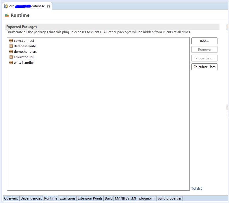

Is the demo.handlers package exported in the manifest (runtime tab)?
Re: Eclipse exported Product file is not working. [message #1817744 is a reply to message #1817743] Thu, 28 November 2019 07:57 Go to previous messageGo to next message
Yes It is added. Check the attached image. index.php/fa/36857/0/

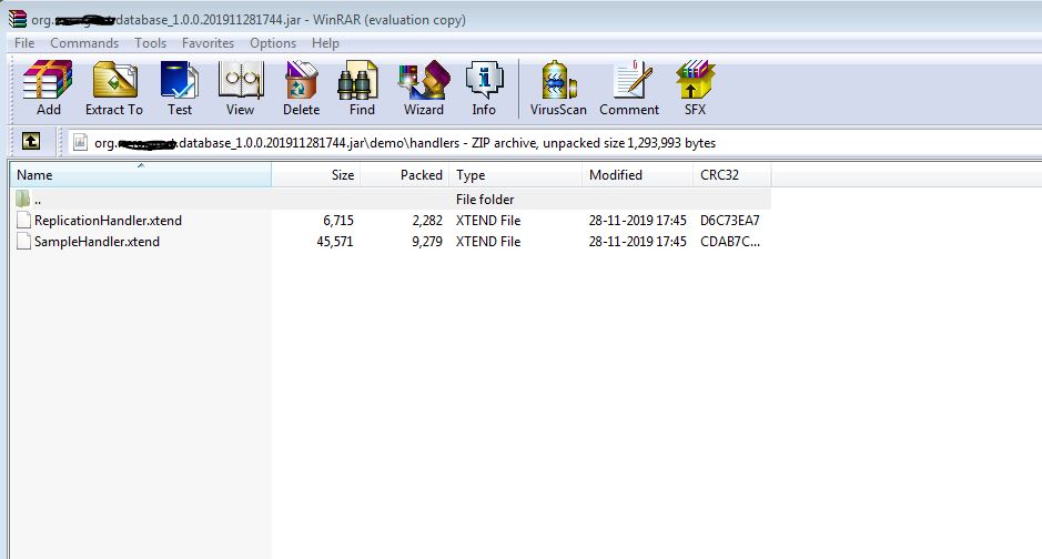

Can you check that your .class file is actually in the jar?
Re: Eclipse exported Product file is not working. [message #1817781 is a reply to message #1817756] Thu, 28 November 2019 23:48 Go to previous messageGo to next message
Yes, I have .xtend file and it is already present in the jar file. I have attached screenshot also.

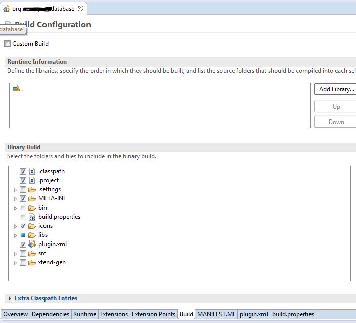

It is resolved Now. I missed .classpath and .project files to adding in Build tab. In database plugin already generated .classpath file. But not added to build tab because of that at the time of exporting product package folder database jar file have not created .class files.

It is odd that you have to include the .classpath and .project file as build targets.
- I have seen what you have warnings on your build.properties file, you should have checked them. Probably you missed including xtend-gen as source folder. (Note that these warnings are there to help you ...)
- I see that you have a libs folder. Make sure that your classpath is correctly set in the Manifest runtime tab. And that your .classpath file is consistent with your Manifest (Press 'update the classpath settings' in the Manifest overview tab).
