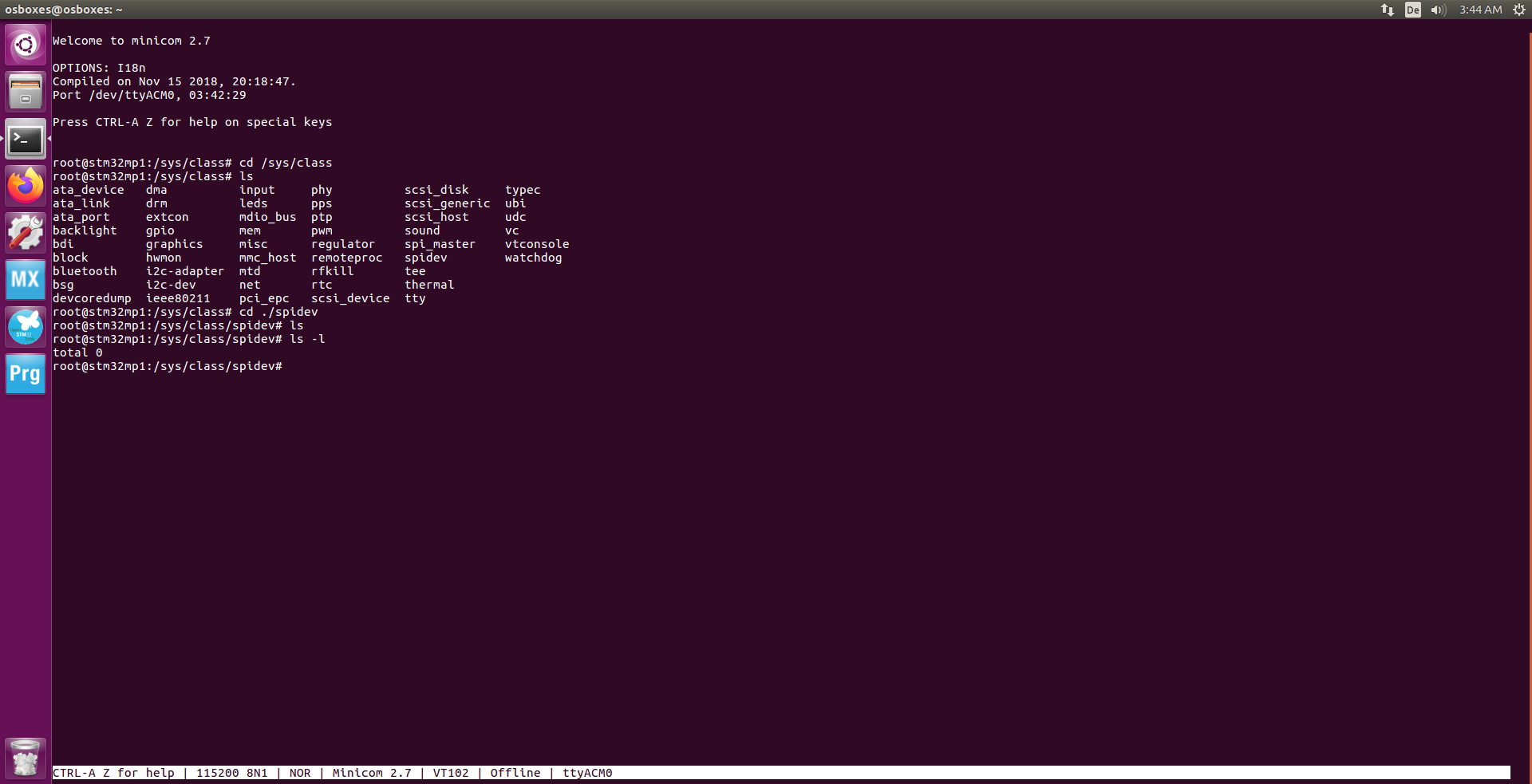

2.On my board I cannot see the directory you mentioned. I only see the spi-master and the spidev directory which seem to be empty.

  • Attachment: spide.png
    (Size: 131.74KB, Downloaded 165 times)
