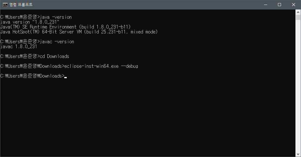

I've tried to install eclipse, but it's connected to the web page displaying the following error and it's experiencing a problem with installation
Unfortunately the Java version needed to run Eclipse Installer couldn't be found on your system. You need the following version or a higher version: Java 1.8.0 (64 Bit)
But my JDK version is Aleady 1.8.0_231(64Bit) and i completed setting up the environment variable. (JAVA_HOME, and Path as System Variable)
Normally, using a different IDE like InteliJ(and it works normally on my computer) but it's not possible because I have to submit it as a university assignment using eclipse.
What should I do?
Included File is my CMD screenshot of checking JDK version

Re: Everythings perfect. But Eclipse installer can't install it for a reason that it can't find the [message #1816837 is a reply to message #1816825] Thu, 07 November 2019 20:52 Go to previous messageGo to next message
As you can see from the attached image, nothing is printed.
And still does not work.
But Error web page shows up...

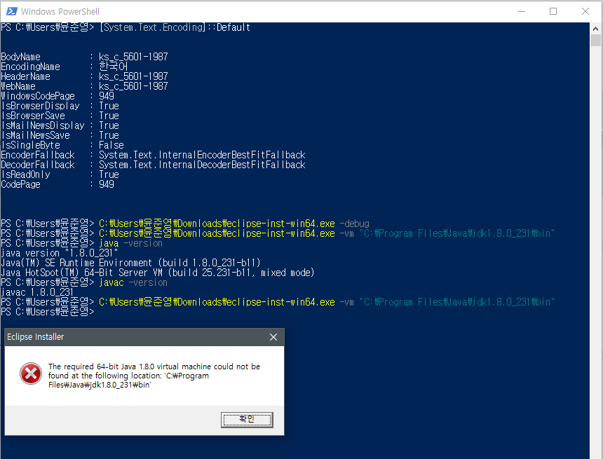

Re: Everythings perfect. But Eclipse installer can't install it for a reason that it can't find the [message #1816911 is a reply to message #1816841] Mon, 11 November 2019 12:02 Go to previous messageGo to next message
I am not good at English. so that I am not sure this answer is what you want. The file attached here is the output result of the command that you showed me.
(ps. I am Korean)

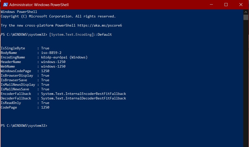

Re: Everythings perfect. But Eclipse installer can't install it for a reason that it can't find the [message #1833561 is a reply to message #1816841] Sat, 17 October 2020 15:33 Go to previous messageGo to next message
I have the same Issue. I tried several JDK.
jdk 14.0.2
jdk 15
OpenJDK 11.0.8.10
Tested them one by one. Totally removing the others, resetting PAHT and JAVA_HOME variables, and restarted my Windows 10 (64bit) on every try.
I tried all the solutions from this thread. Non of them worked for me.
I attached a picture of the result of System.Text.Encoding command.
