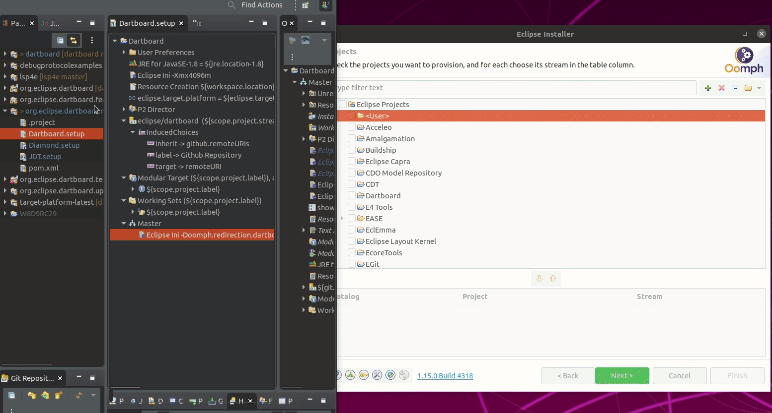

I'm would like to test changes in a project setup file for Dartboard.
Here is what I think should work:
1.) Select "Eclipse IDE for Eclipse commmiters" on the first page of the advanced setup wizard
2.) Switch to second page
3.) If I see an existing Dartboard entry, select it and use the Delete button in the toolbar to remove it
4.) Drag and drop the project file on the correct position in the tree avoiding https://bugs.eclipse.org/bugs/show_bug.cgi?id=552315, this creates an new Dartboard entry
5.) Press next
6.) In the following Variables view I tried an existing entry and a new one (both did not work)
7.) Switch to the next page and press Finish
The Confirmation page shows me only a subset of the task and after running it, I end up with an empty WS.
I'm reset all my changes to the file contributed by Ed but I still end up with an empty WS.
What is wrong with the above procedure? IIRC the first time I did this, it worked fine. I created a animated Gif to show what I'm doing.
index.php/fa/36670/0/
  • Attachment: oomph.gif
    (Size: 4.36MB, Downloaded 572 times)
