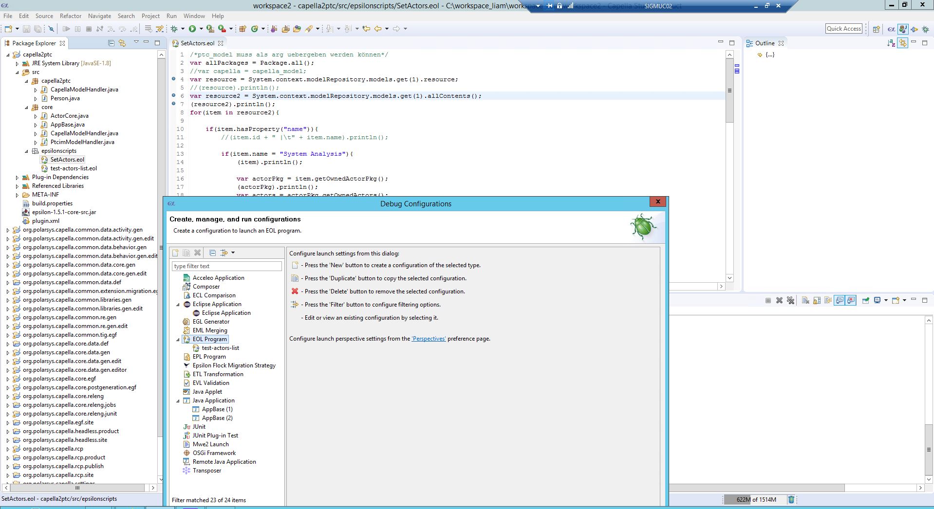

Thanks for your reply. I tried it like the video but it doesnt really work like I thought. So I want to start a java programm that load EOL Data. You can see on the image that I uploaded. I tried to debug SetActors.EOL but when I load debug configurations there are no options for choosing SetActors.eol. The file .eol work without failure, but I just want to know how to debug the .eol data when I start a java project that loading EOL data.

This is not possible out of the box I'm afraid. You may be able to reuse code from the classes in [1] to somehow start the EOL debugger in a new instance of Eclipse but I wouldn't know how to go about this off the top of my head.
Cheers,
Dimitris
