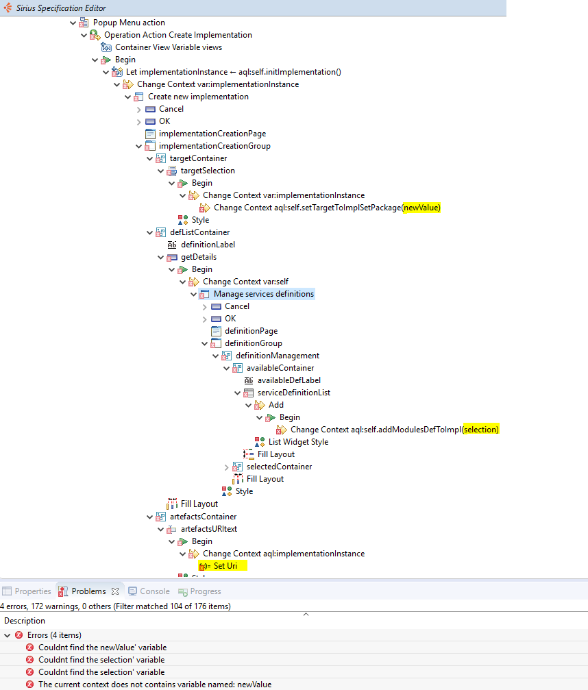

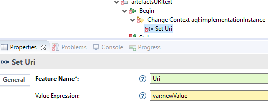

I'm trying to set a pop up menu with dialogs.
This is working as expected but I've a validation issue with Sirius in the specification editor.
I'm using a select box, a list with widget action, and text field. (see screenshot)
To retrieve the values selected by the user, I'm using "var:newValue" and "aql:instance.method(selection)" as described in documentationhttps://www.eclipse.org/sirius/doc/specifier/properties/Properties_View_Description.html#list
This is rejecting me with 2 main errors :
- "Couldnt find the newValue' variable"
- "Couldnt find the selection' variable"
How can I get rid of this error ?
What need to be changed ?
Thank you in advance

Hello Matthieu,
It's a Sirius bug validation.
You can report a bug on the Sirius Bugzilla https://bugs.eclipse.org/bugs/buglist.cgi?classification=Modeling&list_id=18989154&product=Sirius
