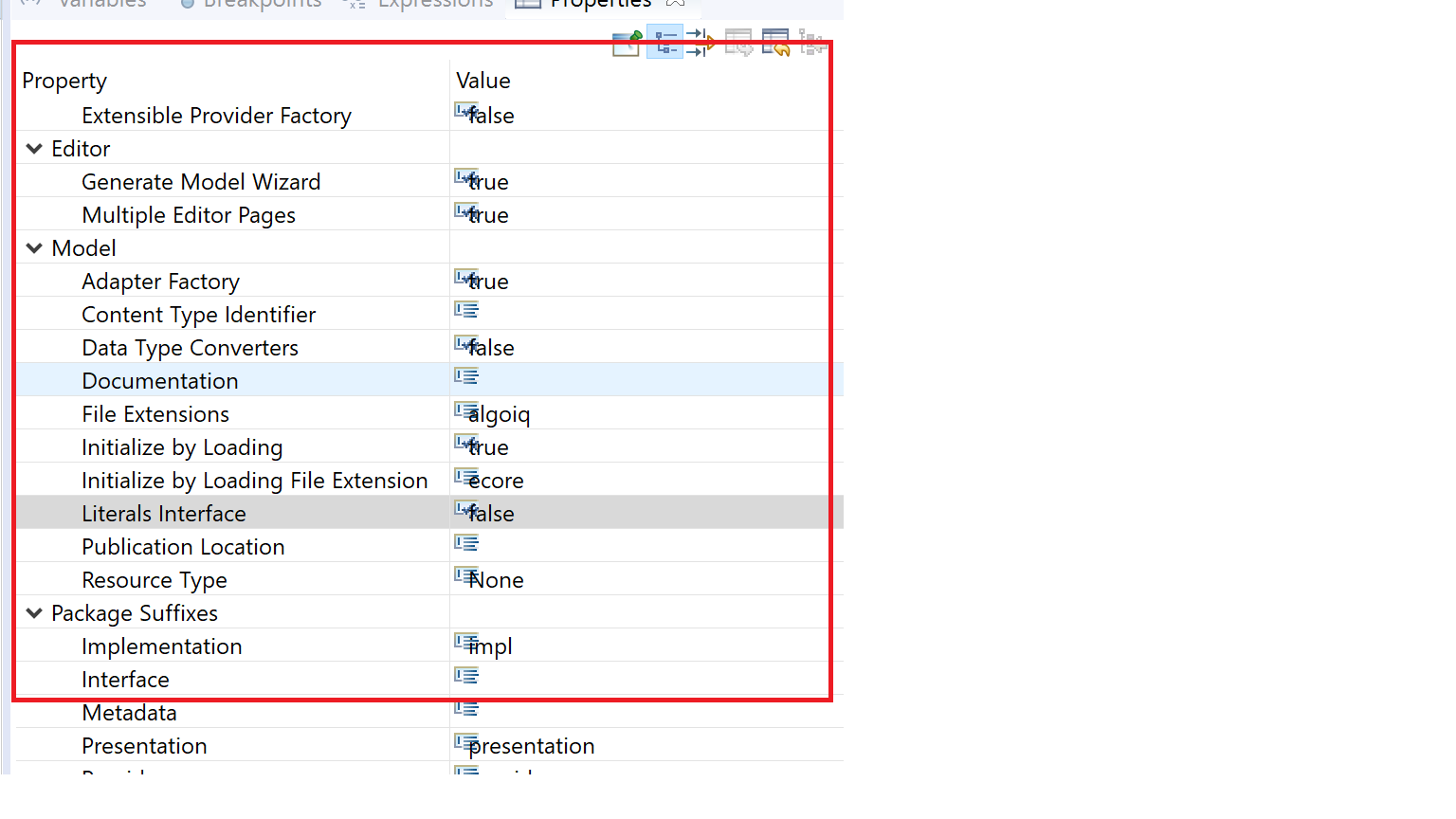

Hi Ed,
Thanks for help.
Yes, "Model-> Literals Interface" is set to false, still I am getting this issue.
  • Attachment: Issue.png
    (Size: 50.35KB, Downloaded 119 times)
[Updated on: Tue, 01 October 2019 05:48] by Moderator
Re: Too many constants, the constant pool for AlgoIQPackage would exceed 65536 entries [message #1815357 is a reply to message #1815352] Tue, 01 October 2019 07:21 Go to previous messageGo to next message
Then your model is probably just too big to represent it reasonably in Java; I've never seen a model so big that it had such a problem. Typically the problem is more likely to get too much byte code for a class's initializers or for a method's body. But it's of course possible to have too many features in a single class such that methods like the XyzImpl.eGet will have too much byte code. I.e., it's always possible to exceed limits. A model with literally 65,000 classes + features does not seem within the capacity of a human being to understand. Presumably this Ecore model was mapped from something else as the source because no human being could or would design such a monstrosity. Perhaps this comes from some obscenely big XML Schema? In that case, you should stop to consider if it's really actually sensible to generate Java code for the model for this use case. Who would actually need to write code against such monstrous generated API? You could just use the *.ecore as a dynamic model instead...
