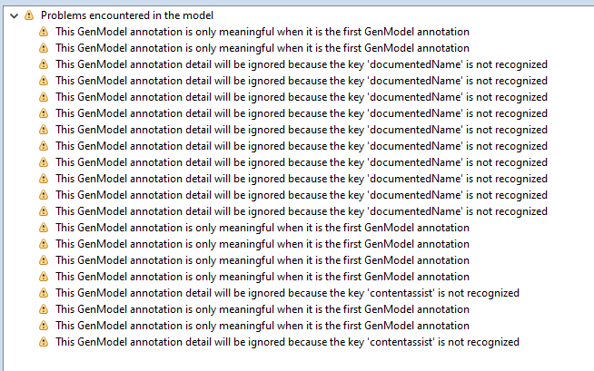

We recently updated from Oxygen.2 (finally) and now I'm getting some warnings when opening my genmodel.

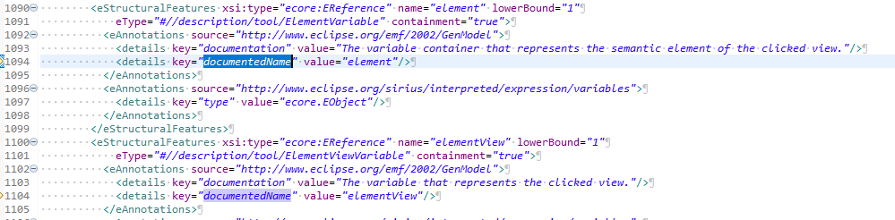

I couldn't get any markers, validating the ecore and genmodel reported no error or warnings and couldn't figure out what those referred to, until I did a text search on "documentedName" that was part of some warnings. I found out it came from a referenced model "viewpoints" from Sirius.
Even when opening the viewpoints genmodel, I get the warnings, but validating that genmodel reports no errors/warnings.
What are these and how can I handle this, other than ignoring or removing from source ? And also why is that being reported at the level of my genmodel?
Alain
[Updated on: Mon, 23 September 2019 07:16] by Moderator
Re: Genmodel warnings with 2019-06 [message #1814951 is a reply to message #1814950] Mon, 23 September 2019 07:27 Go to previous messageGo to next message
GenModel annotations are now validated based on how they are actually processed by the GenModel. Anything that will not be processed (i.e., will not be mapped to something in the GenMode or its children) will get such a warning. These warnings all look to be of this form.
I don't know what Sirius is doing with these annotations, nor why they are using the GenModel's nsURI as source for that purpose; you'll have to ask them the reason for this approach. In any case, these are "just" warnings, and they are not in your model, so you won't be able to fix or avoid them. That's something Sirius will need to do.

Re: Genmodel warnings with 2019-06 [message #1814974 is a reply to message #1814953] Mon, 23 September 2019 11:19 Go to previous messageGo to next message
From what I understand, we (in Sirius) have "always" had these kinds of entries in our ecore models, but they were never copied into the genmodel until recently (https://git.eclipse.org/r/c/144333/ from last June) when we reloaded the genmodels & regen of our code using EMF 2.18.
I don't know what was the reasoning for reusing this nsURI for our own keys at the time (it's probably more than 10 years old). Maybe it was a bad idea but it did not cause any visible ill effect until the regen using EMF 2.18.

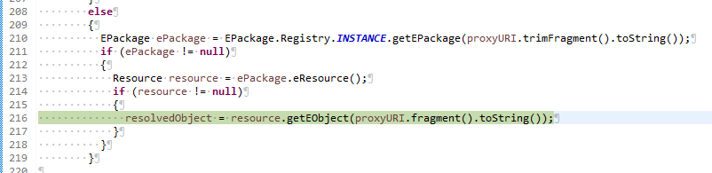

Re: Genmodel warnings with 2019-06 [message #1814997 is a reply to message #1814988] Mon, 23 September 2019 16:58 Go to previous messageGo to next message
Ed,
I looked at the code changes from 2017 onward and zoned in the change on 2018-11-27 labeled [432544] EAnnotation references in nested packages use inexistent base xxxPackageImpl and finally ran a debugging session and it is the culprit.
Ironically, this issue was opened many years ago by a member of my team. The problem is that now the resolution gets "rooted" (the URI.createURI part) on the parent package instead of the root package, but the proxy resolution in EcoreUtil#resolve(EObject proxy, ResourceSet resourceSet) is not adapted to it. On line 213, it gets the resource and might have to go through parents to find it, but then it doesn't adjust the fragment path to account for those navigate parents.
Honestly issue 432544 is not critical but this one is totally breaking. What are the next steps? I surely can open a bugzilla about it but changing the codegen locally is a mess, I might more consider running a locally modified EcoreUtil to re-add the naviaged fragment paths.
