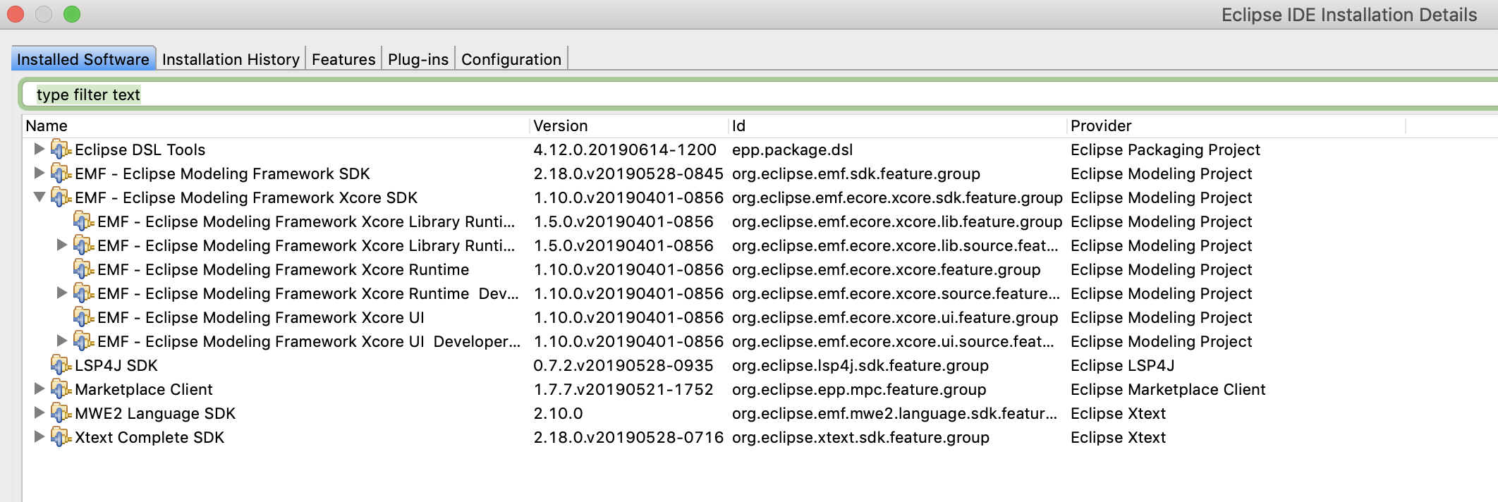

Everything is building fine within eclipse. Now, I'm trying to build via maven, and getting the following error:

So, it appears that I needed to update my target file at io.yaktor.dsl.domain.target/io.yaktor.dsl.domain.target.target to include the xcore stuff. At https://download.eclipse.org/modeling/emf/emf/builds/release/2.18/index.html, I see Xcore SDK 1.10.0 & Xcore Library Runtime 1.5.0, which match the versions that I'm seeing installed in the Xtext version of eclipse (see attached).
I appended the 2.18 EMF repo as a location to my target file:

What did I miss or what am I doing wrong?

Something is fishy. I see this line:
Skipping conflicting project org.eclipse.emf.codegen.ecore at 'archive:file:/Users/matthewadams/.m2/repository/org/eclipse/emf/org.eclipse.emf.codegen.ecore/2.12.0/org.eclipse.emf.codegen.ecore-2.12.0.jar!/' and using 'archive:file:/Users/matthewadams/.m2/repository/p2/osgi/bundle/org.eclipse.emf.codegen.ecore/2.18.0.v20190528-0725/org.eclipse.emf.codegen.ecore-2.18.0.v20190528-0725.jar!/' instead.
But the method it says is missing is one inherited from GenBase which is marked like this:
   * @since 2.15
  void clearCache();
This makes me think that while the log line claims it's using version 2.18, the error message about the missing method suggests it's in actual fact using version 2.12 where that method would indeed be missing.
Also the name of the jar, org.eclipse.emf.codegen.ecore-2.12.0.jar is kind of fishy because that is not a jar name that we'd generally expect to find in any p2 repository, but rather a jar that one could find at Maven central. But then all the conflicting messages have such simple jar names on the left side, so maybe that's a red herring.
Re: Build in eclipse ok, failing via maven with NoSuchMethodError [message #1814546 is a reply to message #1814545] Fri, 13 September 2019 00:25 Go to previous messageGo to next message
Xtext uses emf 2.12 on maven side
So I guess you need to override that for all
EMF plug-ins and not only a part of them
[Updated on: Fri, 13 September 2019 00:33] by Moderator

So this means setting the runtime version to the one of oxygen for code generation in the genmodels should be fine ?
Re: Build in eclipse ok, failing via maven with NoSuchMethodError [message #1814556 is a reply to message #1814553] Fri, 13 September 2019 04:17 Go to previous messageGo to next message
Yes. And of course GenModels themselves can specify the Eclipse target runtime version (which has no impact on the model code, only the editor code) and the EMF target runtime, so even the latest GenModel plugin can and will generate code that is compatible with very very old versions of Eclipse (and very very old versions of Java) if such things have been specified as desired.
Re: Build in eclipse ok, failing via maven with NoSuchMethodError [message #1814586 is a reply to message #1814556] Fri, 13 September 2019 11:03 Go to previous messageGo to next message
Well, I'm glad this spurred a discussion here and in https://github.com/eclipse/xtext/issues/1282. Not sure why things should be different on the maven side from the eclipse side. Personally, I'd strive to ensure that both maven & eclipse were using the exact same artifacts to ensure consistent builds. I do like that the xtext-dev-bom uses exact versions, a practice that I employ & encourage others to.
In any event, what do you recommend I do right now? I read Christian's recommendation of overriding certain maven artifacts for all EMF plugins in my maven build. Exactly which maven artifacts, and, for each artifact, which version would be preferred? Whatever the latest version is?
Thanks again for your help, folks. :)
Re: Build in eclipse ok, failing via maven with NoSuchMethodError [message #1814587 is a reply to message #1814586] Fri, 13 September 2019 11:11 Go to previous messageGo to next message
In the exec section where you run the workflow
Specify all maven artifacts for Ecore emf codegen and Xcore stuff in the latest version
Re: Build in eclipse ok, failing via maven with NoSuchMethodError [message #1814588 is a reply to message #1814586] Fri, 13 September 2019 11:13 Go to previous messageGo to next message
Further, it looks like org.eclipse.emf:org.eclipse.emf.ecore.xcore.lib:1.5.0 is not in maven central: https://search.maven.org/search?q=a:org.eclipse.emf.ecore.xcore.lib shows 1.4.0 as the latest version, which doesn't jibe with https://download.eclipse.org/modeling/emf/emf/builds/release/2.19, AFAICT. Can y'all publish 1.5.0 to maven central? Until that's done, I'm seeing an error inside xtext as per the image attached to this message.
Error text is:
Missing artifact org.eclipse.emf:org.eclipse.emf.ecore.xcore.lib:jar:1.5.0 pom.xml /io.yaktor.dsl.domain.tests line 18 Maven Dependency Problem
[Updated on: Fri, 13 September 2019 11:18] by Moderator
Re: Build in eclipse ok, failing via maven with NoSuchMethodError [message #1814590 is a reply to message #1814587] Fri, 13 September 2019 11:21 Go to previous messageGo to next message
Hmmm...I wonder if I could override it in the xtext-dev-bom...that'd be nice, since it'd be only in one place... I'll give that a try & report back, either way.
Re: Build in eclipse ok, failing via maven with NoSuchMethodError [message #1814591 is a reply to message #1814590] Fri, 13 September 2019 11:34 Go to previous messageGo to next message
FYI, reporting missing org.eclipse.emf:org.eclipse.emf.ecore.xcore.lib:jar:1.5.0 from maven central @ https://bugs.eclipse.org/bugs/show_bug.cgi?id=551060
Re: Build in eclipse ok, failing via maven with NoSuchMethodError [message #1814596 is a reply to message #1814591] Fri, 13 September 2019 13:12 Go to previous messageGo to next message
As I mentioned on the Bugzilla, there is no such version of xcore.lib. The version numbers of each bundle are spelled out on the release page's update site index so the latest version of xcore.lib is 1.4 not 1.5: https://download.eclipse.org/modeling/emf/emf/builds/release/2.19/index.html
Re: Build in eclipse ok, failing via maven with NoSuchMethodError [message #1814599 is a reply to message #1814596] Fri, 13 September 2019 13:52 Go to previous message
Oops, you're right, Ed. My bad. I didn't realize the list of specific versions was present lower on the page.
