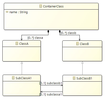

I created an ecore meta model with a class that is a supertype to another class. Lets say the superclass is called ClassA and the other class is SubClassA1.
When I create an instance of SubClassA1, the editor als creates a representation of ClassA. It is not possible to delete only the ClassA representation without deleting the SubClassA1 representation.

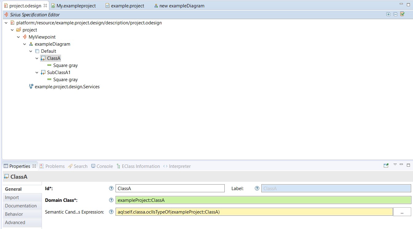

From my own research on the internet I found out, that I am supposed to use the "Semantic Candidates Expression" of the ClassA node to solve this problem. But for some reason, the expressions I found online do not work for me.
Example:
aql:self.yourContainmentReference.oclIsTypeOf(yourPackage::SuperTypeA)
Of course I switched out the nessessary parts. It looked kinda like this.
aql:self.classa.oclIsTypeOf(exampleProject::ClassA)

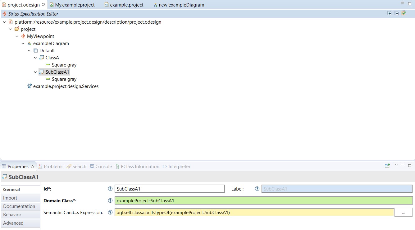

I tried adding the corresponding expression to the SubClass. Now the SubClass does not get displayed either.

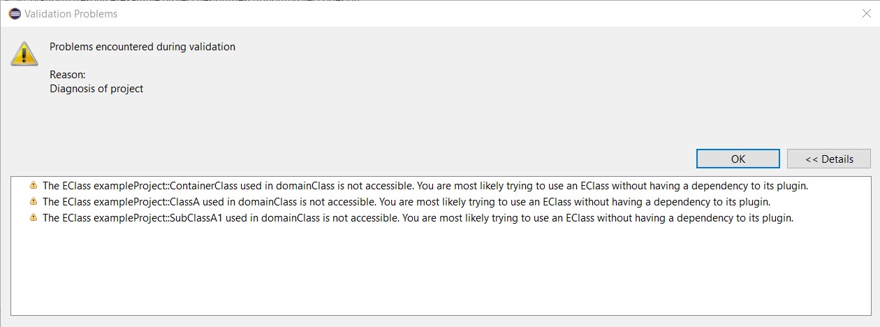

I just validated the odesign file and I got a warning messege that says something about dependencies (I added a screenshot). But I don't know, if that has something to do with the problem at hand.
I added some screenshots to show you my meta model and the expressions.

Ok I think I have a better understanding with the screenshot. I hadn't noticed the first time, but with your expression you are trying to do two thing at once, identify candidates and filter by type so you should use oclAsType to cast, instead of oclIsTypeOf that returns a boolean.
If it is easier, you can do it in two steps. For your candidate expression, you can use only aql:self.classa, as it is the reference in your metamodel. Note that you can also use the expression "feature:classa" that is more performant. Then you want to filter by type, this can be done in the "Precondition Expression" field in the advance tab. Here the expression will be aql:self.oclIsTypeOf(exampleProject::ClassA) or SubClassA1 depending on the mapping.
Concerning the errors about the unaccessible types, can you check that in the Manifest.MF file of your project, you have a dependency to your metamodel? Also, in your .odesign, if you select your DiagramDescription "exampleDiagram", you can go to the metamodel tab and add your metamodel using the registry or the workspace. This should further check that you have access to your metamodel.

Considering the warning messege, I checked and found, that there is no dependency to the meta model project. I did reference it in the metamodel tab of the "exampleDiagram" though. In the Manifest I tried to add it with the Add button, but I can't find the project in the upcoming list.
