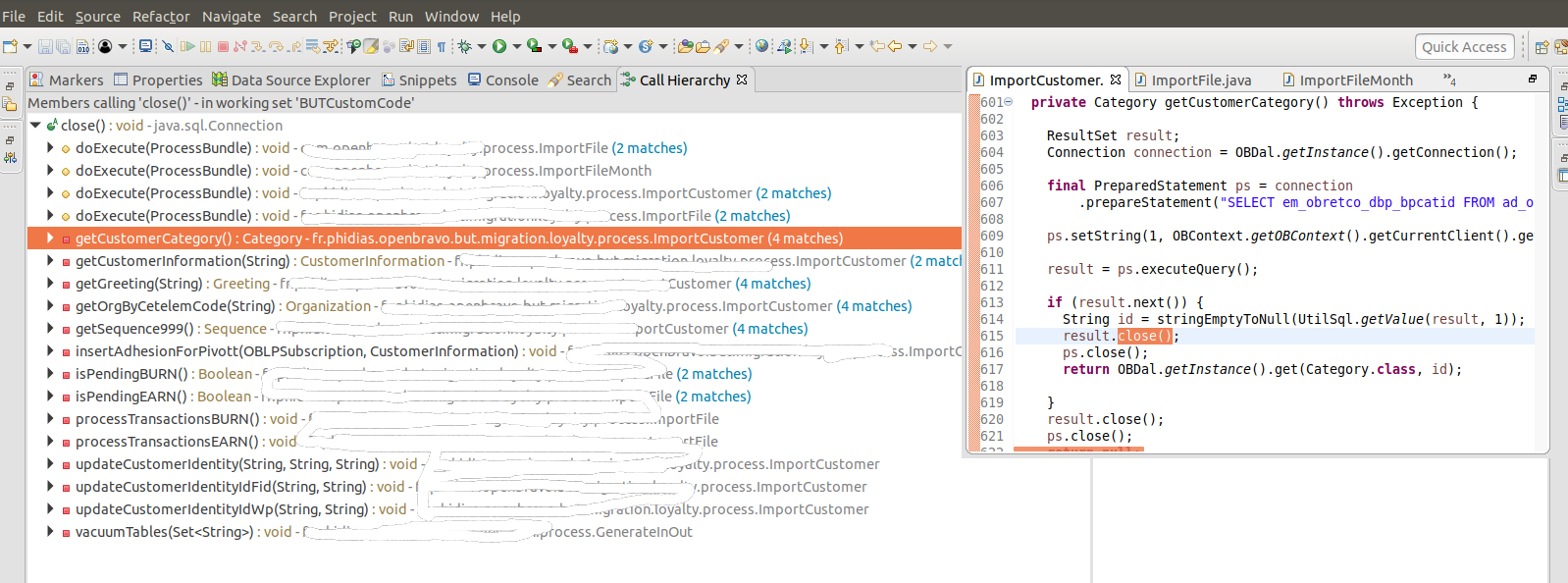

I am trying to find all the calls to close() method from java.sql.Connection
For that I am using the Call Hierarchy feature but for some reason it seems is finding all close() calls no matter what is the Class.
In the image attached you can see that it is showing a close() on a ResultSet.
Any explanation? Am I doing something wrong?
Thanks in advance,
Rafa
Re: Call Hierarchy Question [message #1809321 is a reply to message #1809245] Sat, 13 July 2019 02:11 Go to previous messageGo to next message
Yes, that's just a limitation. That method overrides java.lang.AutoCloseable.close() so any call anywhere on an AutoCloseable might well be actually a call to a Connection. I don't know if it's possible for a class to implement both ResultSet and Connection (which probably makes no sense to actually do), but you see the point...
Re: Call Hierarchy Question [message #1809389 is a reply to message #1809321] Mon, 15 July 2019 06:59 Go to previous message
OK, understood, thank you very much for the clarification
