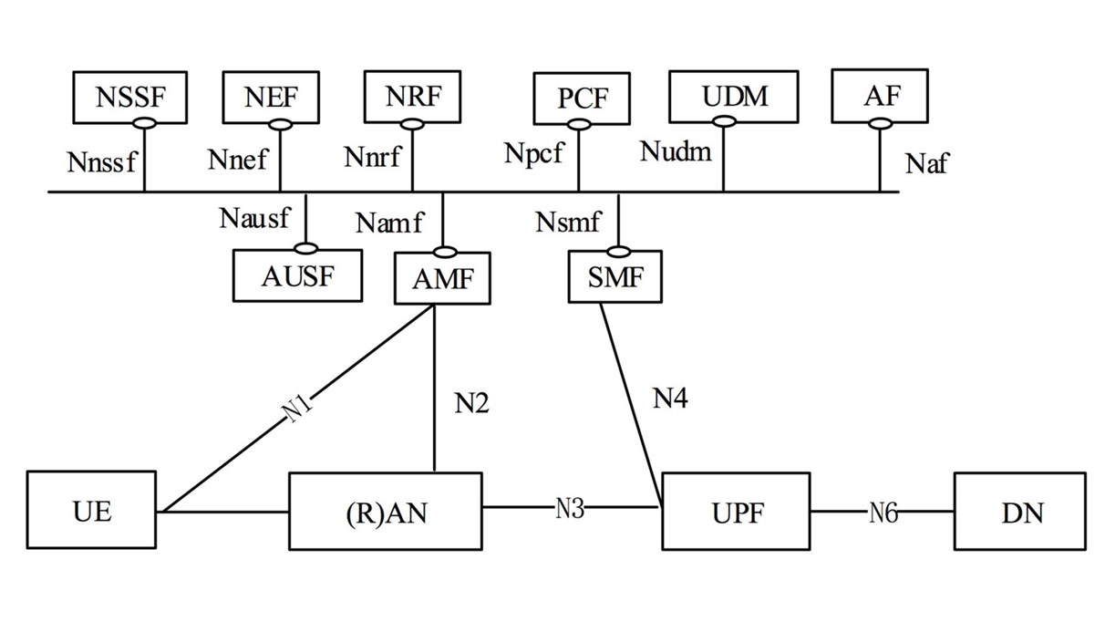

The demand for easily scalable systems that can be tailored for new situations stimulated a migration from telecom-style protocol interfaces to web-based APIs. The 5G core network will be based on what is called "Service-Based Architecture" (SBA), centered around services that can register themselves and subscribe to other services. This enables a more flexible development of new services, as it becomes possible to connect to other components without introducing specific new interfaces. The new system architecture is specified in 3GPP technical specification 23.501:
One of the advantages of the SBA is that there is no need for specialized APIs, a common protocol stack can be used:
More about SBA here:
