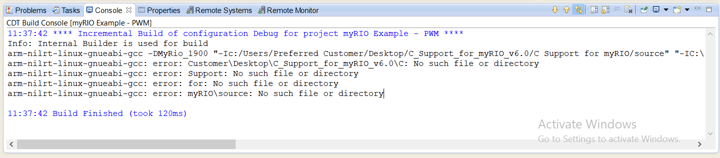

index.php/fa/35707/0/I am trying to run the PWM sample code in C with eclipse and when I am building the project I run into the error of "No such file or directory" when the program should be looking for c:/Users/Preferred Customer/Desktop/C_Support_for_myRIO_v6.0/C Support for myRIO/source.
Instead the program spits out these errors:
arm-nilrt-linux-gnueabi-gcc -DMyRio_1900 "-Ic:/Users/Preferred Customer/Desktop/C_Support_for_myRIO_v6.0/C Support for myRIO/source" "-IC:\\Users\\Preferred Customer\\Desktop\\C_Support_for_myRIO_v6.0\\C Support for myRIO\\source" -O0 -g3 -Wall -c -fmessage-length=0 -mfpu=vfpv3 -mfloat-abi=softfp "--sysroot=C:\\Users\\Preferred" "Customer\\Desktop\\C_Support_for_myRIO_v6.0\\C" Support for "myRIO\\source" -o main.o "..\\main.c"
arm-nilrt-linux-gnueabi-gcc: error: Customer\Desktop\C_Support_for_myRIO_v6.0\C: No such file or directory
arm-nilrt-linux-gnueabi-gcc: error: Support: No such file or directory
arm-nilrt-linux-gnueabi-gcc: error: for: No such file or directory
arm-nilrt-linux-gnueabi-gcc: error: myRIO\source: No such file or directory
It appears that it is splitting up that file location based on the spaces. I have attempted to add quotes around the file path but that has not worked. I am working on windows 10 professional. Any ideas?
