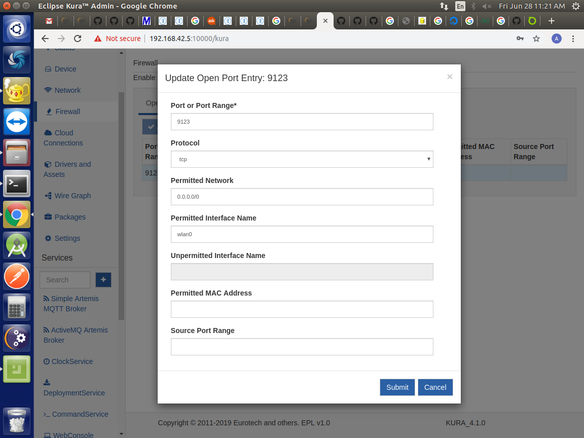

I configure database by following this document--https://eclipse.github.io/kura/builtin/h2-database.html#creating-a-new-h2-database-instance
i am on the end of it but not able to open db web server, i just want to know what the meaning of this line-->
Make sure to review the firewall configuration in order to ensure that the server is reachable from the external process.
which is written in docment.
i already did the configuration the file is attached bellow ,
Thanks and Regards,
Abhishek
[Updated on: Fri, 28 June 2019 01:53] by Moderator

That is user responsibility to open the needed firewall ports either using Kura (if supported) or directly acting to the firewall of your host system.

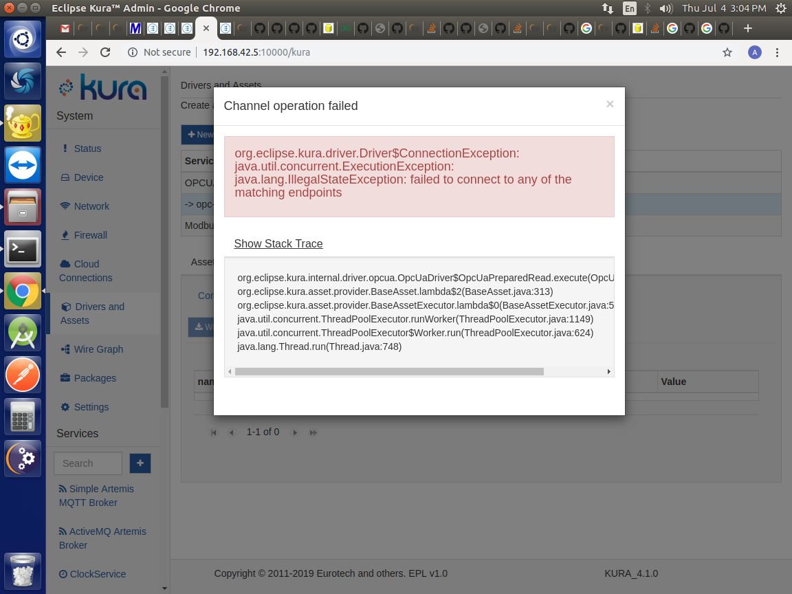

Re: firewall warning [message #1809369 is a reply to message #1809115] Mon, 15 July 2019 03:23 Go to previous messageGo to next message
hello,
I tried so many time to connect to opcua Driver, i want to know how wired graph is working with opcua driver, so in previous post i got an error as no UserTokenPolicy with UserTokenType.UserName found, i deleted the asset and again start the process by following this document-->https://esf.eurotech.com/v5.0.0/docs/opcua-application-in-kura-wires
now the error i am getting is failed to connect to any of the matching endpoints so i change the endpoint as 1235 in opcua driver so i got an warning as,java.net.ConnectException: Connection refused: localhost/127.0.0.1:1235
So will you please guide me how to solve this issue ??
Thanks and Regards,
Abhi
Re: firewall warning [message #1809387 is a reply to message #1809369] Mon, 15 July 2019 06:25 Go to previous messageGo to next message
I would suggest you to perform the following steps:
1. Open port 1234 (or the port on which the server is listening on) in Kura firewall and try to connect using an external OPC-UA client, to verify that the server is up and running.
2. The
message can indicate that you are providing username/password to a server that does not require authentication. In order to stop sending username and password, try clear the corresponding parameters in driver configuration (they should be blank for disabling sending credentials).
3.
can mean that no process is listening on port 1235, using port 1234 was probably correct.
Let me know if it works,
Best Regards,
Nicola

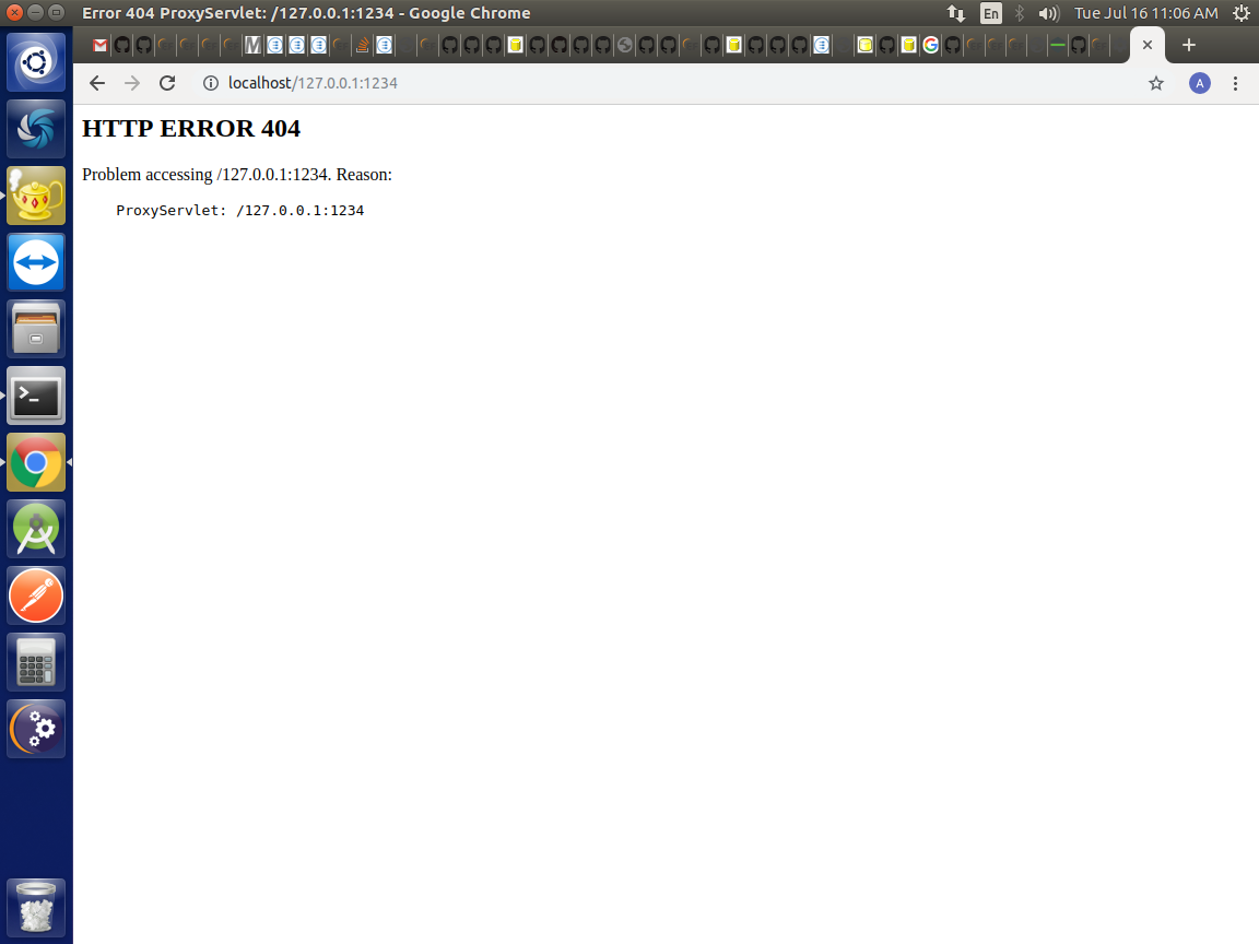

Re: firewall warning [message #1809427 is a reply to message #1809387] Tue, 16 July 2019 01:37 Go to previous messageGo to next message
Hello Nicola,
Thanks for your reply,
1) So I remove the username and password then i go to the data tab it's opining but with some message in status, it's come as failure when i click on that it's gives the message that ( Reason: Got bad status: 2150891520) .
2) when i try to open this localhost/127.0.0.1:1234 it's ask for user and password i give username as (admin) and password as (admin ), so i got these message-->
HTTP ERROR 404
Problem accessing /127.0.0.1:1234. Reason:
ProxyServlet: /127.0.0.1:1234
it's not opening

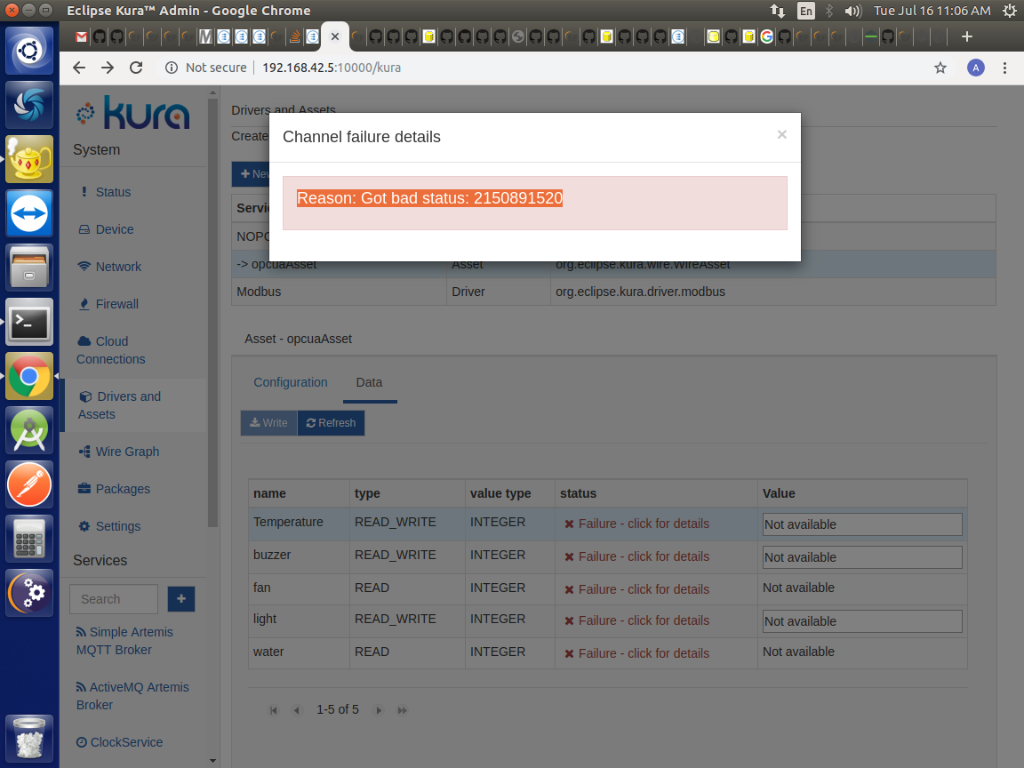

3) One thing i want to ask that i created opcua asset and their i created channels which is connected to wire graph and in wire graph their is logger so where i will see the logs or my data which i created in opcua asset i think this url (localhost/127.0.0.1:1234) will show my data if i am wrong please correct me. right now this is not opning??
Thanks and Regards,
Abhi

Re: firewall warning [message #1809505 is a reply to message #1809427] Wed, 17 July 2019 02:54 Go to previous messageGo to next message
According to the document OPC-UA server simulator bundle is install in ESF. It will create a simulated OPC-UA server that exposes some sensors (light, temperature and water sensor) and some actuators (buzzer, led and fan). So where i can see all these data, and how we can change the value of these data??
https://esf.eurotech.com/v5.0.0/docs/opcua-application-in-kura-wires#section-configure-wires-opc-ua-application
Thanks and Regards,
Abhi
[Updated on: Wed, 17 July 2019 03:12] by Moderator
Re: firewall warning [message #1809506 is a reply to message #1809505] Wed, 17 July 2019 03:19 Go to previous messageGo to next message
From your answer 2 I assume you are trying to connect to http://localhost/127.0.0.1:1234 with some HTTP client (e.g a web browser), that request will not be served by the OPC-UA server but by the embedded Jetty web server instance.
If a request fails with code 2150891520, it should mean that you are trying to access a node that does not exist on the server (a node with the requested id cannot be found by the server).
The good news is that the fact that you can see this error implies that the driver was able to successfully connect and authenticate with the server, so firewall and global driver settings should be ok.
The next step is configuring asset channels.
For this purpose, I would suggest you to try connecting to the OPCUA server with a graphical OPCUA client (e.g a desktop or smartphone app), browse the server nodes with that and determine the the ids of the nodes you are interested reading/writing.
Once you discovered these node ids, you can use that information to configure the OPCUA driver channels.
I'm sorry but I cannot provide support for the tutorial you mentioned, as it is related to a commercial product.
Nicola

Hello Nicola,
Thank you so much for your valuable suggestions, now I able to getting the data in data tab of opc-ua driver but one thing i want to ask for h2db service i created h2db server but i am not able to access the server in my web browser, This is the document which i am following-->https://eclipse.github.io/kura/builtin/h2-database.html
The kura is install in my device i connected it through wifi ip, but i am not able to access http://192.168.42.5:9123/
I checked firewall connection also, i change this -webPort 9123 -webAllowOthers -ifExists port to 9124 but result is same
Please give me some hint about this and thank you again for your quick reply.

Re: firewall warning [message #1809642 is a reply to message #1809517] Fri, 19 July 2019 04:49 Go to previous messageGo to next message
I wouldn't know what's going on.
Configuring the firewall to allow TCP connections to TCP port 9123 and configuring the DbServer instance as follows should be enough:
db.server.enabled -> true
db.server.type -> WEB
db.server.commandline -> -webPort 9123 -webAllowOthers -ifExists
You can check if the server is listening on port 9123 by running curl directly on the device, try the following command:
curl http://localhost:9123/
If curl is not available you can try the wget, or try installing it.
If you get a response like the following, then the server is up and running:
<!DOCTYPE HTML PUBLIC "-//W3C//DTD HTML 4.01 Transitional//EN" "http://www.w3.org/TR/html4/loose.dtd">
Copyright 2004-2019 H2 Group. Multiple-Licensed under the MPL 2.0,
and the EPL 1.0 (http://h2database.com/html/license.html).
Initial Developer: H2 Group
<html><head>
<meta http-equiv="Content-Type" content="text/html;charset=utf-8" />
<title>H2 Console</title>
<link rel="stylesheet" type="text/css" href="stylesheet.css" />
<script type="text/javascript">
location.href = 'login.jsp?jsessionid=27400cbfbaa762671551d314eece54d7';
</script>
</head>
<body style="margin: 20px;">
<h1>Welcome to H2</h1>
<h2>No Javascript</h2>
If you are not automatically redirected to the login page, then
Javascript is currently disabled or your browser does not support Javascript.
For this application to work, Javascript is essential.
Please enable Javascript now, or use another web browser that supports it.
</body></html>
If the curl test succeeds, then there might be something wrong with the firewall. Otherwise, do you have other services using port 9123?
Nicola

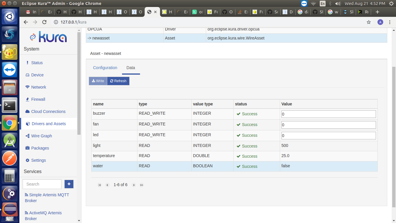

Re: firewall warning [message #1810889 is a reply to message #1810768] Wed, 21 August 2019 07:23 Go to previous messageGo to next message
Actually i am using opc-ua driver in that i created some channels like( temperature,water,led) i am able to see those data on server of h2Db But i want to know how to modify or change those data ?
where exactly it store, i am able to see those data in data tab also please find the attachment bellow,
Thanks and regards,
Abhi
  • Attachment: opcuanew1.png
    (Size: 180.54KB, Downloaded 137 times)
Re: firewall warning [message #1810890 is a reply to message #1810889] Wed, 21 August 2019 07:37 Go to previous messageGo to next message
if the channel supports writes, you should be able to change the values.
It depends on the sensors/actuators you have attached to the OPCUA server, if you are allowed to change those values.

I did't attached any sensors/actuators i just use OPC-UA server simulator with opc-ua driver and create asset or checking the data on server of h2db but the data which i am getting is fluctuating sometime temperature comes as 25.666 or sometime it's come as 27 so i want to know how to access the data so that i can understand why it's happening,
Thanks and regards,
Abhi
Re: firewall warning [message #1810897 is a reply to message #1810895] Wed, 21 August 2019 08:51 Go to previous messageGo to next message
For what I remember the simulator exposes data based on a certain rule. The fact that you see different values may be related to the sampling rate you are using.
It's not clear to me what you mean when you say that you want to access the data. My question is: where? in the simulator or in kura after you fetched this data?

Hii,
in simulator how to access the data ? because it's coming through simulator node id,
or in kura after fetching the data h2db create (.mv.db) file i can access that if other storage is their please let me know
Thanks and regards,
Abhi
Re: firewall warning [message #1810901 is a reply to message #1810900] Wed, 21 August 2019 09:42 Go to previous messageGo to next message
I think that the simulator logic is fixed and hardcoded.
If you want to change it, you'll need to update the simulator's source code and redeploy it.

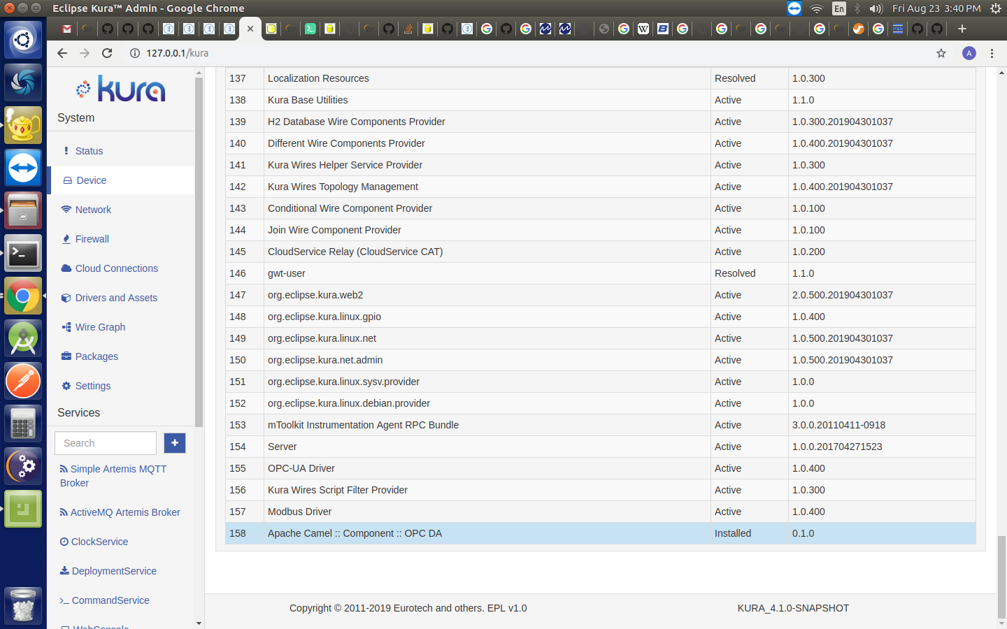

But i installed one bundle (Apache Camel :: Component :: OPC DA » 0.1.0) Its showing installed in device (bundle tab ) but i am not able to active it, how to activate that bundle because i tried with "+" button but i am not able to get component name on that, Is their other way to activate the bundle ?
Thanks and Regards,
Abhi
  • Attachment: bundle.png
    (Size: 270.71KB, Downloaded 156 times)
[Updated on: Fri, 23 August 2019 06:18] by Moderator
Re: firewall warning [message #1811034 is a reply to message #1810999] Sat, 24 August 2019 12:17 Go to previous message
the OPC DA bundle is not an official Eclipse Kura bundle. I believe you should try to contact the author to get help on this.
