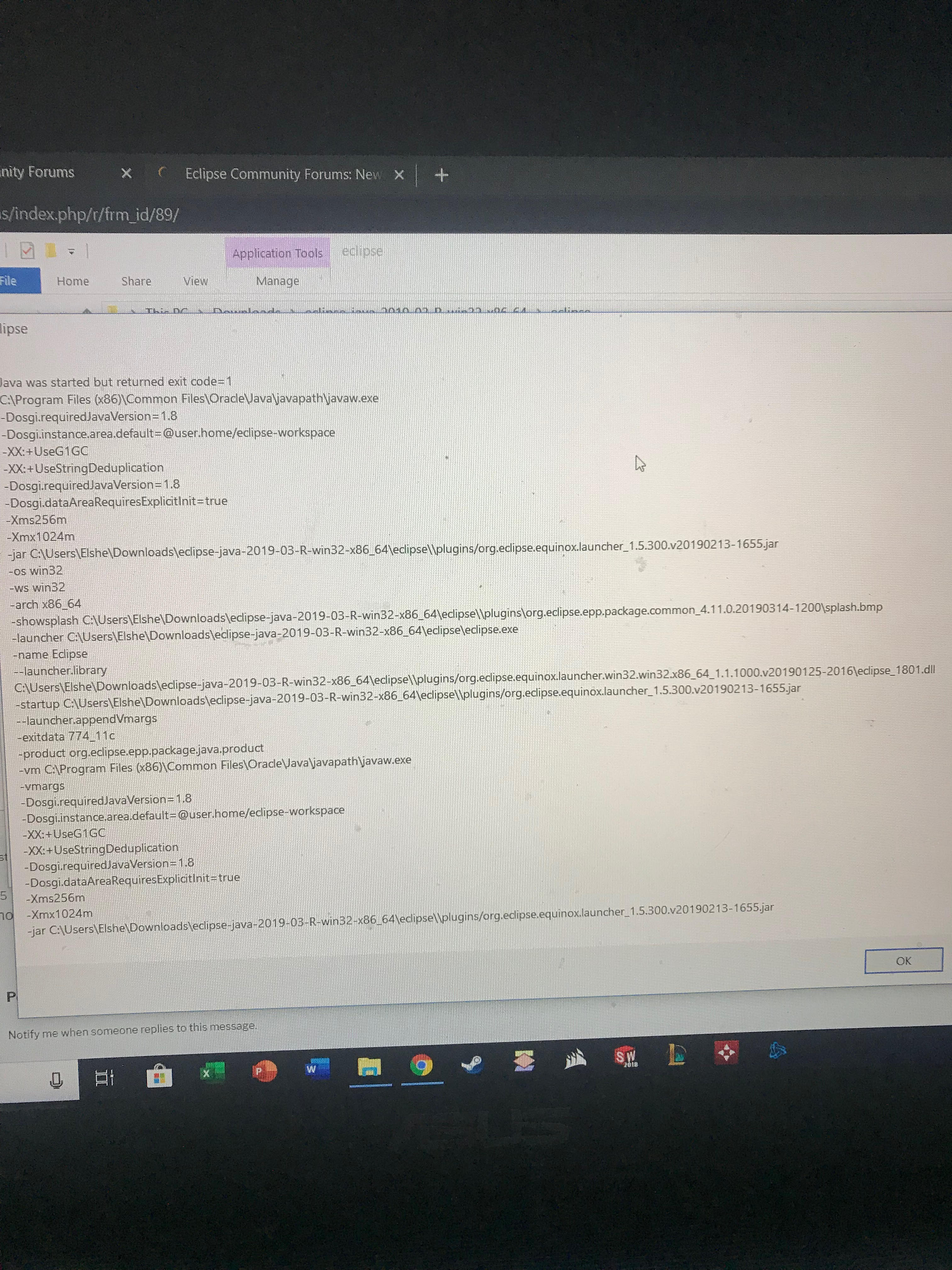

The picture posted is my exit code that I received when I tried to use eclipse, I have found multiple solutions but they all regard an ini file that looks way different then the one that I have received, here is what my ini file looks like.
-startup
plugins/org.eclipse.equinox.launcher_1.5.300.v20190213-1655.jar
--launcher.library
plugins/org.eclipse.equinox.launcher.win32.win32.x86_64_1.1.1000.v20190125-2016
-product
org.eclipse.epp.package.java.product
-showsplash
org.eclipse.epp.package.common
--launcher.defaultAction
openFile
openFile
--launcher.appendVmargs
-vmargs
-Dosgi.requiredJavaVersion=1.8
-Dosgi.instance.area.default=@user.home/eclipse-workspace
-XX:+UseG1GC
-XX:+UseStringDeduplication
--add-modules=ALL-SYSTEM
-Dosgi.dataAreaRequiresExplicitInit=true
-Xms256m
-Xmx1024m
How should I go about resolving this issue? Also to note, my jdk file is indeed 64-bit.

You may have installed a 64 bit JDK, but that is not what is being used. If you look at the line right after the exit code you can see that it's using something from Program Files (x86), so that's definitely a 32 bit VM. Perhaps use the installer to create your installation. It looks for Java installations in the registry and makes sure that the installation you create has a -vm option to use a correct JVM. The latest version of the installer http://www.eclipse.org/downloads/download.php?file=/oomph/products/latest/eclipse-inst-win64.exe now properly finds Java 11 and 12 installations, which Oracle in their infinite wisdom decided to put in a different place in the system registry...
