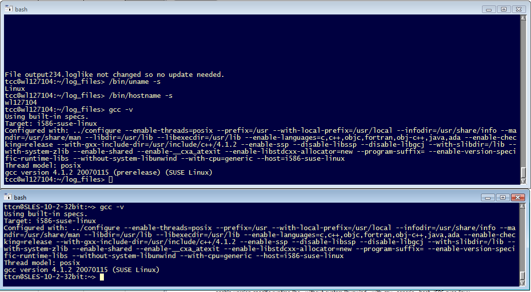

Yet the most frustrating one was an issue with a particular version of gcc (or actually two versions)
The user reported, that everything works fine, but the logmerge utility drops about every 3rd character from the merged output.
It took us weeks until we figured out that the problem was coming from a mismatch in gcc versions.
TITAN was built on a SLES with gcc version 4.1.2 20070115 (SUSE Linux) ... the user has a SLES with gcc version 4.1.2 20070115 (prerelease) (SUSE Linux)
I hope this can be seen on this image https://drive.google.com/open?id=1ae3Y_5UzK7m0BljmAR0lakyIEw5V-Zhl
But the biggest problem was, that while we could not figure out what the issue was ... the users reporting this issue could also not "really" go on with their work.
Meaning, that they were developing their tests, and executing them ... but as the logs were not correct, had to spend an enormous part of the productive time with either guessing which letters might be missing, or trying to pair up log events from dozens of log files.
So even from just pure technical point of views, having such strict checks has several benefits for us and our users (or had in the past):
