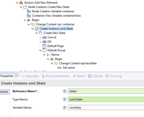

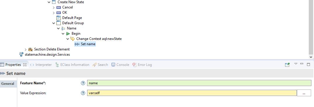

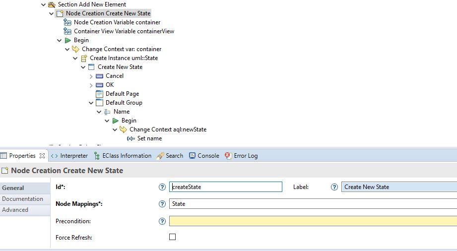

I want to create tool that will create new element and in my case that will be state in one statemachine.
I have followed this tutorial (https://wiki.eclipse.org/Sirius/Tutorials/AdvancedTutorial) but I simply can't find my mistake.
Here is what I have done:
https://1.bp.blogspot.com/-BdiKDQ5uohE/XKug99ql6DI/AAAAAAAAFVk/jzr11is1S54tOOg4cxV3dmh8qm-0h2yWQCLcBGAs/s1600/1_sirius.JPG
https://1.bp.blogspot.com/-uiX-Ux16T2Q/XKuhFSgwRdI/AAAAAAAAFVo/xNJ6NEWvEG8OosmXgLsTJKd8Z_QcRDFOACLcBGAs/s1600/2_sirius.JPG
https://3.bp.blogspot.com/-EdKxW1b49LM/XKuhF_KNOlI/AAAAAAAAFVs/pShow7RmuBIzHDRS_RQd7cYdjRCy51B_ACLcBGAs/s1600/3_sirius.JPG
I don't know that should be Value expression in the last picture. Can someone help me? Where is mistake and why state isn't created?
I want to add specific name that and that's all...
Thank you.

Re: Element Creation Tool doesn't work [message #1805175 is a reply to message #1805161] Tue, 09 April 2019 05:20 Go to previous messageGo to next message
The expression will be aql:newValue. You have an example here : http://imgur.com/a/MDbkk. Or in this thread: https://www.eclipse.org/forums/index.php?t=msg&th=1087747&goto=1769248&#msg_1769248
Florian
Re: Element Creation Tool doesn't work [message #1805178 is a reply to message #1805175] Tue, 09 April 2019 05:47 Go to previous message
Thank you for your reply. I have tried that before posting this topic but that doesn't work either (in my case).
