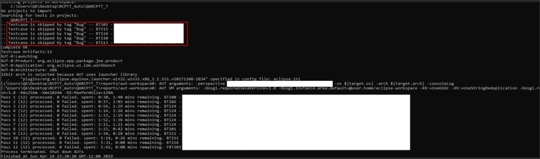

Re: How to skip RCPTT test case execution [message #1805448 is a reply to message #1804972] Mon, 15 April 2019 08:46 Go to previous message
Thanks Olga for your reply. I have marked some test cases with tag Bugs and executed all test cases with command line Test Runner. I could see that some test cases have been skipped but generated HTML report shows zero skipped test cases. I have used Test Runner v2.3.
Please refer to the screenshot in the attachment section.
