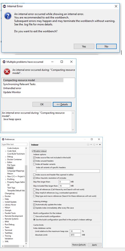

I am running Eclipse 2018-12 on windows 10 machine with 64GB of memory. I have very large C++ project (8993 .cc file and 3241 header files) that is normally built on a Linux machine. I have imported the project to windows machine with Cygwin GCC installed on it. I just want to browse the source files, I am NOT building the project on this windows machine. I end up with this error
"An internal error occurred during: "Compacting resource model".
Java heap space
I have allocated 32GB of memory allocate to Eclipse heap (-Xmx32768m) in the eclipse.ini file but eclipse dies trying to build the index with the C/C++Indexer at 52%.
After 45% it seems parsing is very very slow it took 30 minutes to get to up to 48% at which point at Eclipse memory usage is 16.5GB. When C/C++Indexer is at 50% Eclipse memory usage jumps 18.4GB and when C/C++Indexer is at 52% Eclipse memory usage is around 35.542GB. it stays at 52% and memory usage falls to 34.7 GB and appears to be hung but eventually errors out with
Java heap space
Then memory use show around 26GB.

Preferences for Indexer
Limit relative to the Maximum heap space: 10%
Absolute limit: 3072 MB
Eclipse.Ini file
