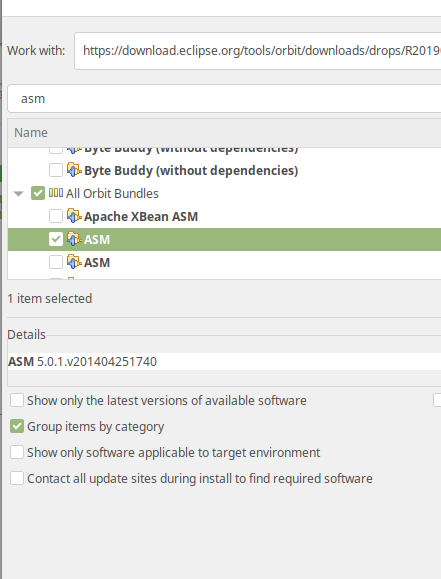

Re: Issues updating Eclipse | 2018-12 → 2019-03 [message #1804665 is a reply to message #1804661] Fri, 29 March 2019 14:47 Go to previous messageGo to next message
xtext Xtext - 2.12 needs asm 5.0.1 that is not there.
i dont know xtext wont get updated in your setup and how your available update sites look like
i dont know if where is anything in spring that needs that.
i assume that additionally installing asm 5.0.1 from the orbit update site could resolve that issue. (it should be in the list if you add the update site and untick categorize plugins and show latest only)
(i recommend you to do a backup before trying)
Re: Issues updating Eclipse | 2018-12 → 2019-03 [message #1804667 is a reply to message #1804665] Fri, 29 March 2019 14:53 Go to previous messageGo to next message
Ok. I'll try installing asm 5.
The problem i, when I go to install software and I have https://download.eclipse.org/tools/orbit/downloads/drops/R20190226160451/repository/
in the "work with:" url, a lot of things come up. I have no idea what to include either.

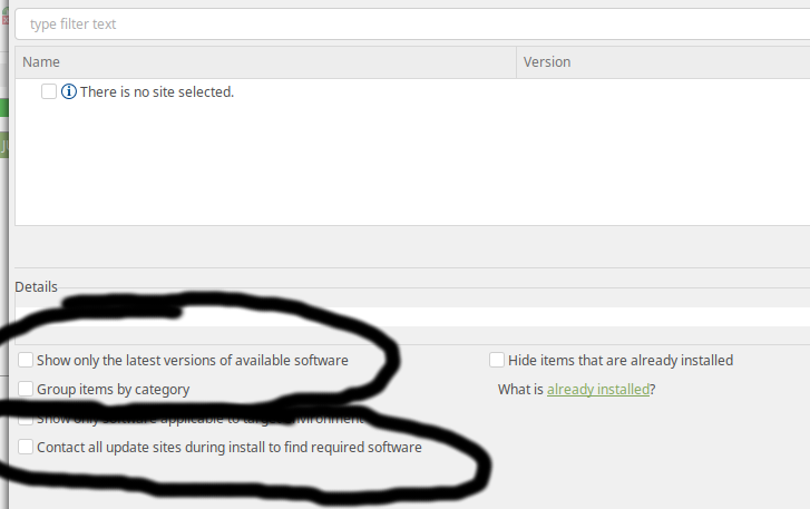

Re: Issues updating Eclipse | 2018-12 → 2019-03 [message #1804668 is a reply to message #1804667] Fri, 29 March 2019 14:56 Go to previous messageGo to next message
you can untick the "user other update sites option as well"
then the orbit update site should be considered only
index.php/fa/35162/0/
[Updated on: Fri, 29 March 2019 14:59] by Moderator
Re: Issues updating Eclipse | 2018-12 → 2019-03 [message #1804669 is a reply to message #1804668] Fri, 29 March 2019 14:59 Go to previous messageGo to next message
Christian Dietrich wrote on Fri, 29 March 2019 18:56
I sadly do not have that checkbox.
Re: Issues updating Eclipse | 2018-12 → 2019-03 [message #1804670 is a reply to message #1804669] Fri, 29 March 2019 14:59 Go to previous messageGo to next message
added a screenshot above
Re: Issues updating Eclipse | 2018-12 → 2019-03 [message #1804671 is a reply to message #1804670] Fri, 29 March 2019 15:01 Go to previous messageGo to next message
Christian Dietrich wrote on Fri, 29 March 2019 18:59
I see what you mean now.
So I only want "Eclipse Orbit Recipes Aggregation Feature"?

no. you select asm 5.0.1 from the orbit update site
index.php/fa/35163/0/
[Updated on: Fri, 29 March 2019 15:08] by Moderator
Re: Issues updating Eclipse | 2018-12 → 2019-03 [message #1804674 is a reply to message #1804672] Fri, 29 March 2019 15:07 Go to previous messageGo to next message
Christian Dietrich wrote on Fri, 29 March 2019 19:05
Found it... I needed "Group items by category" still checked for some reason.
[Updated on: Fri, 29 March 2019 15:09] by Moderator
Re: Issues updating Eclipse | 2018-12 → 2019-03 [message #1804675 is a reply to message #1804674] Fri, 29 March 2019 15:09 Go to previous messageGo to next message
they have changed it. you now have to tick group by category
Re: Issues updating Eclipse | 2018-12 → 2019-03 [message #1804676 is a reply to message #1804675] Fri, 29 March 2019 15:10 Go to previous messageGo to next message
