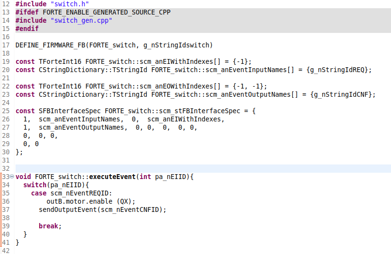

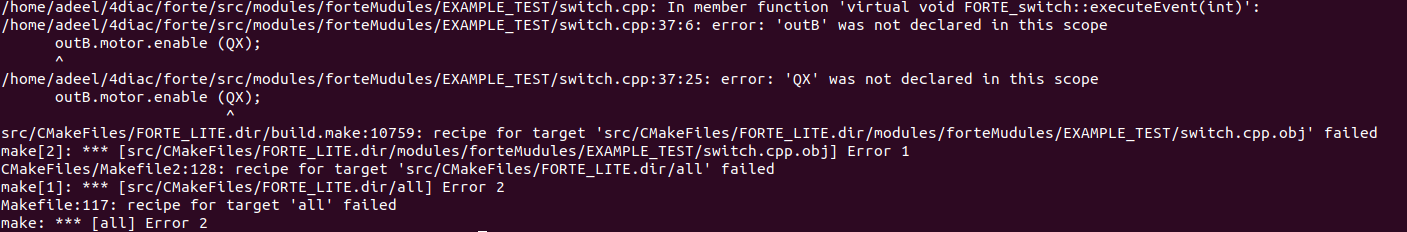

I am facing a problem during compiling the code of a SIFB with a cross compiler. How can I include the parameter features in a right way for ev3dev into SIFB because the cross compiler don't know about outB,motor,enable,QX etc. (https://www.eclipse.org/4diac/en_help.php?helppage=html/parameters/parameters.html#ev3). Should I add some wiring features or what should I add? The SIFB code and compiling error is shown in the attached pictures.

based on what I see from your screenshots you have two errors,
The first is, that INs and OUTs are not direct variables, but hidden behind function calls. So instead of
outB.motor.enable(QX);
you have to write
outB().motor.enable(QX());
, assuming outB is also a IN or OUT of your FB.
The other thing is, that you FB definition seems to be wrong. Could it be that your INs and OUTs of your FB are missing from the C++ file? If yes first check our FB definition in 4diac-IDE and then reexport it.

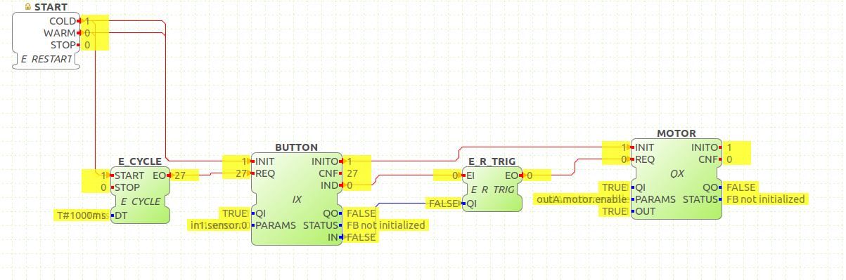

Thanks dear Martin for your quick response. Do you have some idea why the fuction blocks (BUTTON, MOTOR) are not initiating/starting? as you can see in attached screenshot 3. ev3 device is connected and forte is running on it.

I would recommend to not automatically start the E_CYCLE directly from the E_RESTART. The many E_CYCLE events are shadowing any other error message from init. Better for testing do not connect the START event of E_CYCLE and invkoe the START later from 4diac IDE with the trigger event feature. Regarding the initlisation problem: is the sensor or the actuature connected to your EV3?

There was actually two problems:
1.It is required to configure, generate and build the ev3 environment into the forte executable. if you are working with cmake then you will find a tick mark of FORTE_MODULE_LMS_EV3.
2.There is needed to correct the implementation code of processinterface.cpp file in /forte/src/modules/lms_ev3. The function name "pushBack" is needed to replace with standard call "push_back" from the c++ "vector" library.
if you do this then hopefully the function blocks will initialize.
