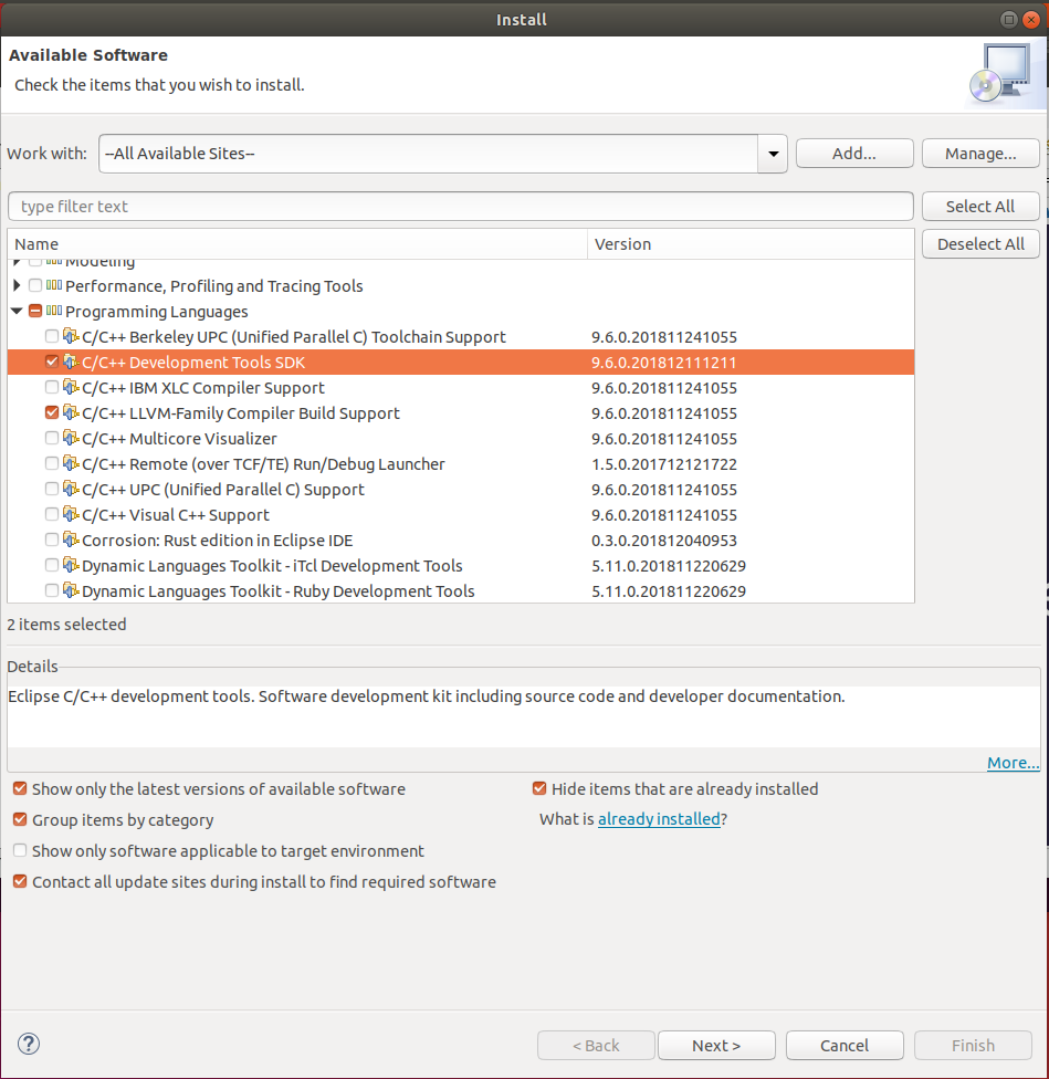

Help->Install New Software-> Select "All Available Sites" from the pull down menu next to the Add button.
Select C/C++ Development Tools and C/C++ LLVM Family-Compiler as shown in 20-13-24.png
Select Next->Next->Accept Terms/Finish->(pop up)Restart Now to restart the IDE

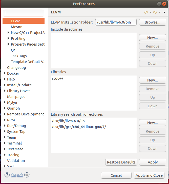

From the Preferences menu I now have an LLVM option under C/C++ and will attempt to set library search path directory and LLVM installation folder.
Noteworthy: The LLVM dialog had the following pre-filled entries. The Libraries section had stdc++ and 'Library search path directories had ' /usr/lib/gcc/x86_64-linux-gnu/7/'

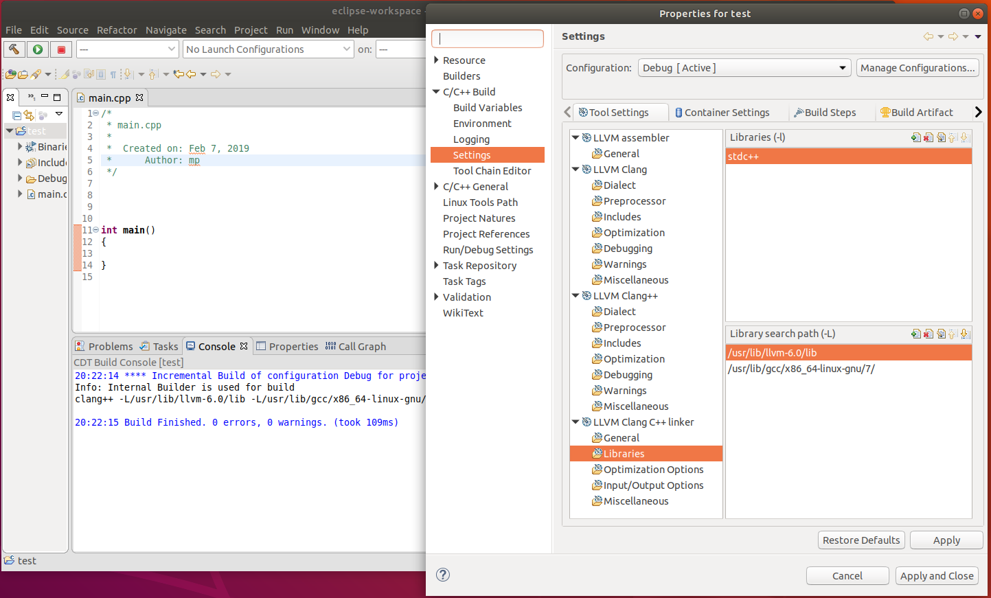

If I create a managed project and choose LLVM with Clang (Lang) the search path and stdc++ is reflected as shown in 20-23-55.png.
Herein lies the issue. I've tried to delete ' /usr/lib/gcc/x86_64-linux-gnu/7/' and stdc++ from my project and the LLVM menu to no avail. Those entries keep recurring (coming back) automatically during compilation.
What i want is libc++ not libstdc++ and the path should not reflect 'gcc' but my clang path. How can i fix this?
The installer picks those entries by default and that's not what I want.
