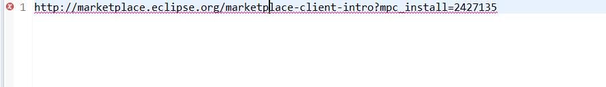

Hello, I am trying to learn how to automate test scripts in Java using a Selenium/Cucumber BDD. To set up the environment, I need to install the Natural language plugin from the Eclipse Marketplace. https://marketplace.eclipse.org/content/natural
Sounds simple enough and I followed the instructions, but when I click and drag the install button into my eclipse program, the URL shows on the program, but it did not install into Eclipse. When I hovered over the error, it says: "missing 'Feature' at http://marketplace.eclipse.org/marketplace-cliet-intro?mpc_install=2427135"
(The url is what I copied into eclipse)
I also tried adding Feature at the top before the line, but that did not work either.
Thank you!
  • Attachment: 1.png
    (Size: 4.06KB, Downloaded 317 times)

The "Errors" tab of that plugin may provide clues:
Installable Units Reported:
org.agileware.natural.cucumber.feature.feature.group,0.7.6.201505100000
Detailed Message:
Cannot complete the install because one or more required items could not be found. Software being installed: Cucumber Editor 0.7.6.201505100000 (org.agileware.natural.cucumber.feature.feature.group 0.7.6.201505100000) Missing requirement: Cucumber Editor 0.7.6.201505100000 (org.agileware.natural.cucumber.feature.feature.group 0.7.6.201505100000) requires 'org.eclipse.xtext 2.1.0' but it could not be found
Can you check which version of XText you're using?
