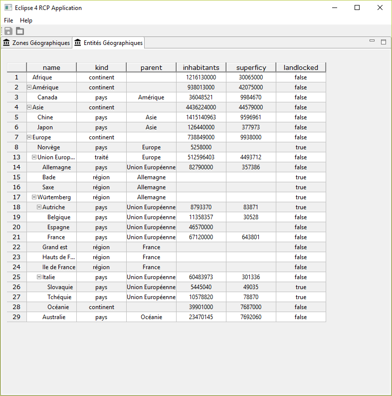

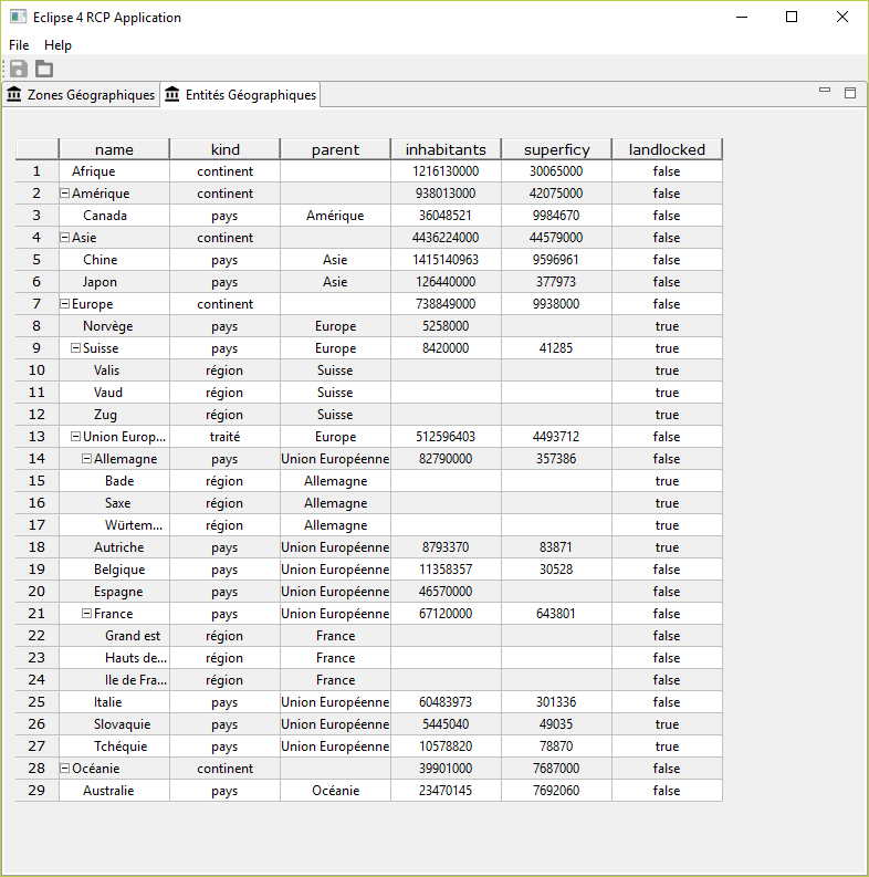

As for "doesn't render properly" and "generally becomes mangled", here is a screenshot, before and after: The RowHide command just doesn't hide one row: It also hides that Row children (so it is somehow aware about the tree structure), but the rendering process doesn't care about the tree structure anymore after that, which causes the tree to be rendered uncorrectly.
I just used the context menu command Hide Row on Row 9.

See Row 17 & 18 in the "after" image, and compare with the same items in the "before" image: they are shown with children they don't have. Conversely, Row 14 in the "before" image has lost its own children.
Furthermore, and logically, when you click on the +/- signs in the "after" tree, nothing happens.
