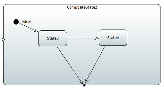

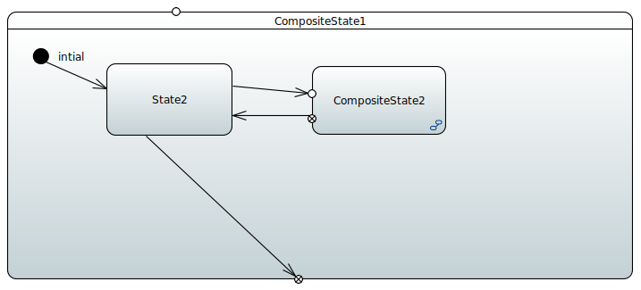

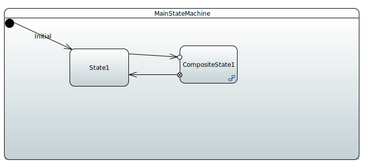

Please see attached pictures of the following created using Papyrus for Real-Time 1.0:
1. Main State Machine containing two states (State1 and CompositeState1)
2. CompositeState1 has State2 and CompositeState2
3. CompositeState2 has State3 and State4
I am unable to find a way to exit out of CompositeState2 (which is inside CompositeState1) and transition to State1 (through the exit point or some other way). Please clarify how to achieve this.
Note that there is a way to transition from CompositeState2 to State2 through the exit point in CompositeState2 but not transition from CompositeState2 to the exit point in CompositeState1

I'm not sure what exactly you want to achieve, but given these diagrams, if you want to exit CompositeState2 and end in State1, you need a transition from CompositeState2 to an exit point of CompositeState1 and then a transition (without trigger) from this exit point to State1., like the one you have for State2. You can share exit points, or you can use different exit points and give them different names to distinguish them, if for example you wanted to go from the second exit point to a different state in the top-level. In UML-RT there is no possible way of having transitions that "cross state boundaries" without passing through an exit point or entry point. This is one of the differences between UML-RT State Machines and UML State Machines, but it is only a syntactic difference. Going through an exit point does not affect the behaviour.

1. If I add a transition from State 2 to CompositeState1, it creates an exit point and a valid transition
2. If I add an exit point in CompositeState1, then add the transition from State2 to this exit point, it creates the (valid) transition
Observations for transitioning from A COMPOSITE STATE to an exit point of composite state:
1. If I add a transition from CompositeState2 to CompositeState1, it creates an exit point and a valid transition
2. If I add an exit point in CompositeState1, then add the transition from CompositeState2 to this exit point, it removes the transition
