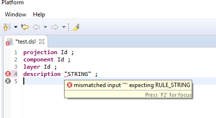

Re: Error in creating fragment for STRING [message #1799735 is a reply to message #1799728] Thu, 13 December 2018 03:12 Go to previous messageGo to next message
Thank you Karsten. After implementing the syntax you suggested, the artifacts are generated without errors. But when I try to type the syntax 'description' in runtime, I get the error that I have attached with this reply.
Could you kindly help me overcome this error?
Re: Error in creating fragment for STRING [message #1799738 is a reply to message #1799735] Thu, 13 December 2018 03:17 Go to previous messageGo to next message
the fragment misses a NOT i think (have a look at the string rule in the superclass)
(i dont understand what your intention with that rule is)
[Updated on: Thu, 13 December 2018 03:19] by Moderator
Re: Error in creating fragment for STRING [message #1799740 is a reply to message #1799735] Thu, 13 December 2018 03:24 Go to previous messageGo to next message
terminal STRING
Re: Error in creating fragment for STRING [message #1799744 is a reply to message #1799740] Thu, 13 December 2018 03:58 Go to previous messageGo to next message
Thank you Karsten and Christian! It is working fine now.

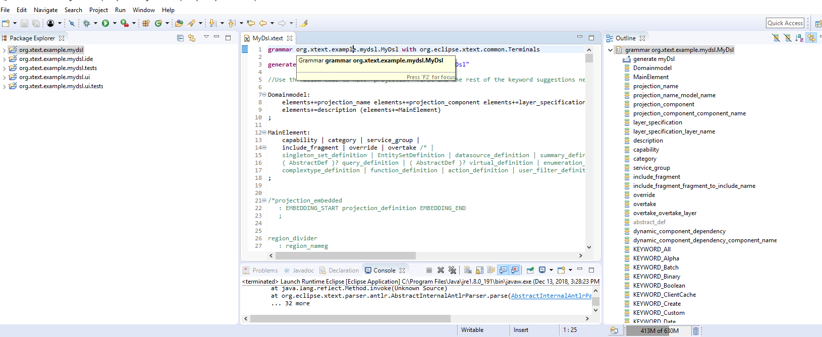

Re: Error in creating fragment for STRING [message #1799759 is a reply to message #1799753] Thu, 13 December 2018 05:17 Go to previous messageGo to next message
Do you mean the Rules listed down in the outline tab, as in the attached pictire below?
  • Attachment: xtext.png
    (Size: 93.77KB, Downloaded 118 times)
Re: Error in creating fragment for STRING [message #1799763 is a reply to message #1799759] Thu, 13 December 2018 05:36 Go to previous messageGo to next message
no just move the cursor on the "org.eclipse.xtext.common.Terminals"
and F3 or crtl+click
Re: Error in creating fragment for STRING [message #1799765 is a reply to message #1799763] Thu, 13 December 2018 05:42 Go to previous message
Thank you Christian. Ctrl+click worked.
