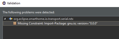

I am very new in SmartHome and I'm starting to develop binding with the use of "rxtx" I encountered the problem shown in the attached screenshot.
Can anyone tell me what I am doing wrong?

Simply also add the "com.neuronrobotics.nrjavaserial" bundle to your launch configuration, this provides the io.gnu package, so all should be fine then.

Thank you very much for your help.
