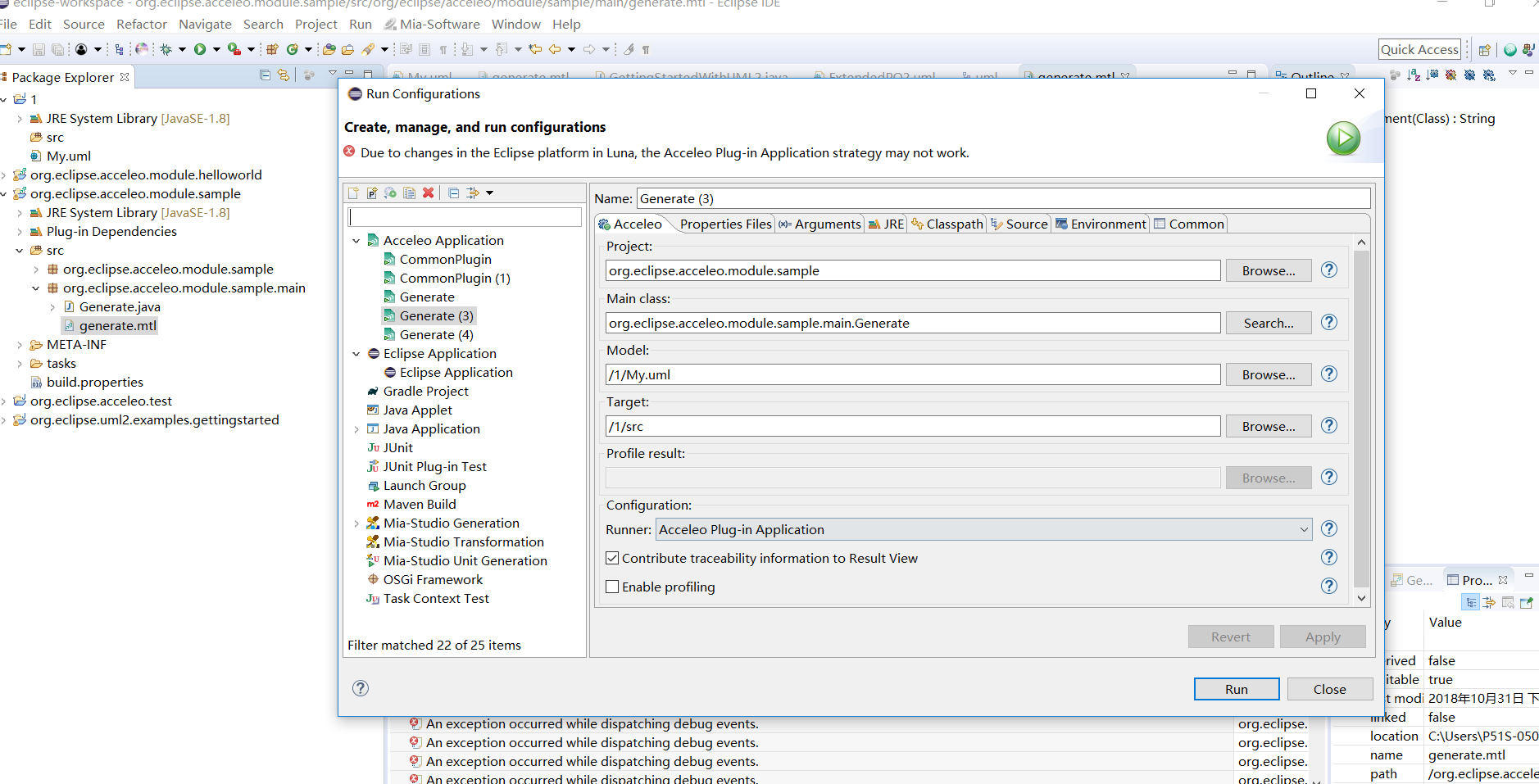

Re: The problems occurs when I follow the Acceleo Getting Started guidance in the wiki to generate j [message #1797479 is a reply to message #1797353] Wed, 31 October 2018 09:12 Go to previous messageGo to next message
Hi, I uploaded my test project and also with the configuration. The problems are the same as I proposed firstly. Could you try my project and if you successes, please let me know how to do it. Thank you!

Re: The problems occurs when I follow the Acceleo Getting Started guidance in the wiki to generate j [message #1797486 is a reply to message #1797479] Wed, 31 October 2018 10:48 Go to previous messageGo to next message

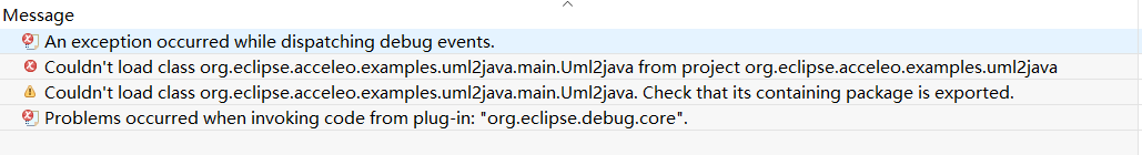

Re: The problems occurs when I follow the Acceleo Getting Started guidance in the wiki to generate j [message #1797577 is a reply to message #1797486] Fri, 02 November 2018 04:07 Go to previous messageGo to next message
Thank you for your suggestion!
I see your comments and read your paper. If the M2M can also convent the model to text ,can you show me the example and the tutorial?
Additionally, I update the Acceleo, andt try the uml2java sample. When I run the uml2java.mtl,the error log shows some errors as seen in the attachment.
Is there anything I should do which is not shown in the tutorial?

Re: The problems occurs when I follow the Acceleo Getting Started guidance in the wiki to generate j [message #1797578 is a reply to message #1797577] Fri, 02 November 2018 04:58 Go to previous messageGo to next message
