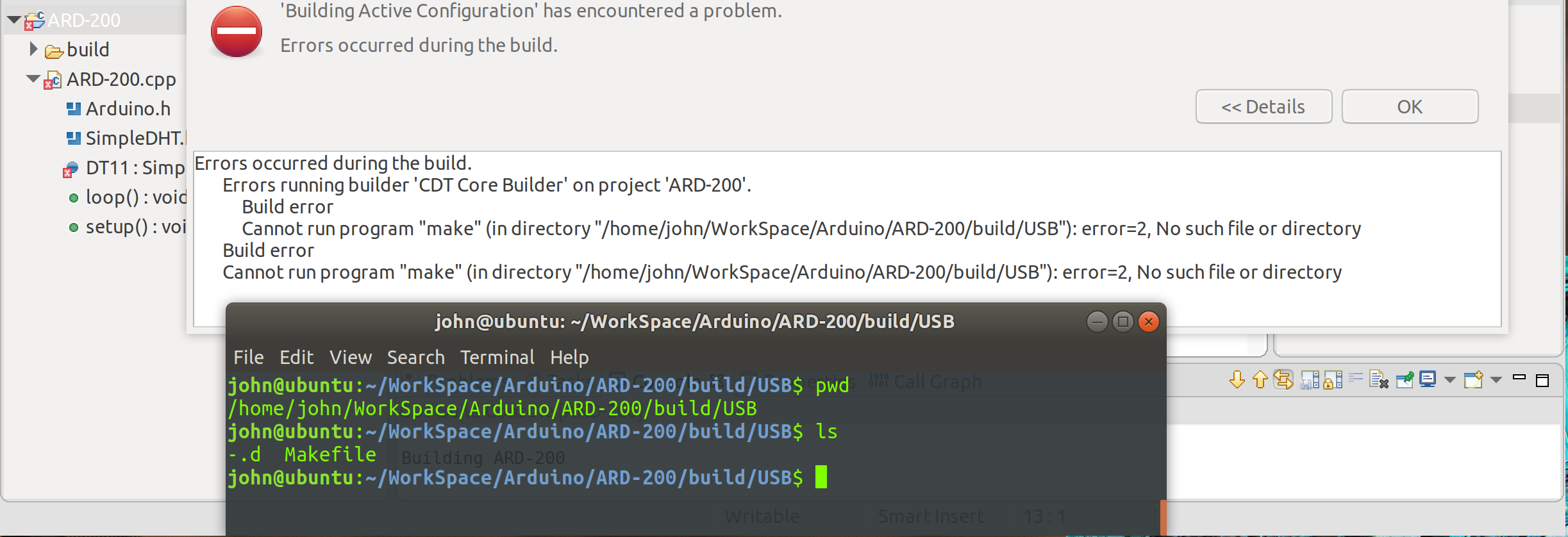

It's the simple thing in eclipse that never seem to work. Just trying to start a project can take literally days. I'm on my third day trying to restart a project that I set down a couple months ago.
When setting up an arduino project, the makefile (that eclipse itself created) cannot be found by eclipse. I'm baffled. I've tried it 4 times created different ones deleted them (they came back) and eclipse is not capable of finding what it created.
This of course is a brick wall completely stopping any progress. If anyone has any insight please comment. It is all appreciated.

The error is saying "make" can't be found.
Check your path.
https://stackoverflow.com/questions/1950974/cannot-run-program-make-launching-failed-in-eclipse
https://stackoverflow.com/questions/44149997/createprocess-error-2-the-system-cannot-find-the-file-specified?noredirect=1&lq=1
