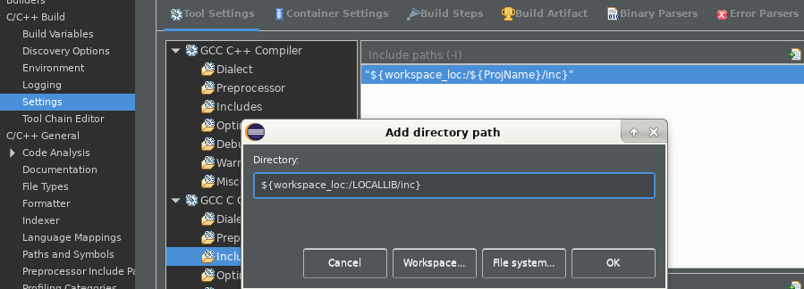

You need to tell eclipse which project is being referenced.
You may not be able to directly use macros that aren't among the Build Variables.
You probably want to use ${workspace_loc:/<project>/inc}
Note that this uses the WORKSPACE_LOC in the resource page for <project>
When you are setting the tool options (Add Directory Path with -I for example)

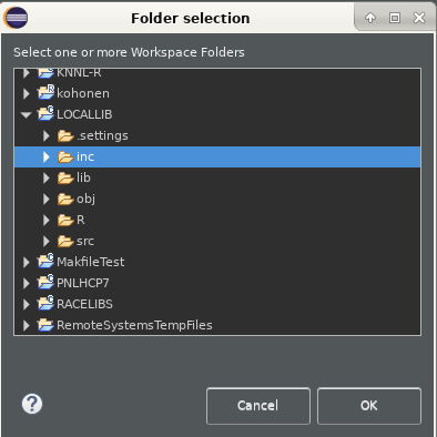

use the Wokspace... button to include a directory from one of your projects in the workspace.
You will be given a list of directories within the workspace to choose from.
When you select one, it will format the macro call for you.
The following selects the inc directory in project LOCALLIB
index.php/fa/33788/0/
index.php/fa/33787/0/

Re: Linked resource variables not expanded when passed to compiler [message #1794790 is a reply to message #1794483] Thu, 06 September 2018 10:10 Go to previous message
If the directory isn't in a workspace
then use the File System ... button instead of the Workspace ... button
when adding the include path.
See the "Add directory path" dialog above.
If you still want to make a variable
then you probably should use a build variable for SRC_LOC
Project --> Properties --> C/C++ Build --> Variables
