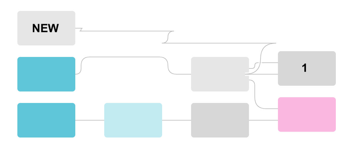

However, adding a new node to the graph is troublesome. The new node is always added on the top-left of the graph (see attachment)

Yep, that's because the node has coordinates (0, 0) when it is created and is thus placed in the top left corner. We currently don't have algorithms that support this level of interactivity - sorry.
