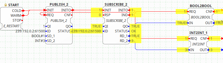

Sorry for writing again. The issue is quite strange because I saw at https://www.eclipse.org/4diac/en_help.php that with events it is supposed to work. Instead, using constant values, it stops working. I made the same to show the issue. Maybe I am wrong, or maybe it is buggy? I am using FORTE 1.9

Re: SUBSCRIBE_2 and PUBLISH_2 issue [message #1791349 is a reply to message #1791347] Thu, 28 June 2018 05:40 Go to previous messageGo to next message
Hi!
The problem is that RD_1 is unconnected. As RDs are of type ANY, you need to typify the output by connecting it to a typed input. The easiest solution would be to connect an INT2INT FB to you RD_1, in order to correctly typify it.
Best regards
Martin

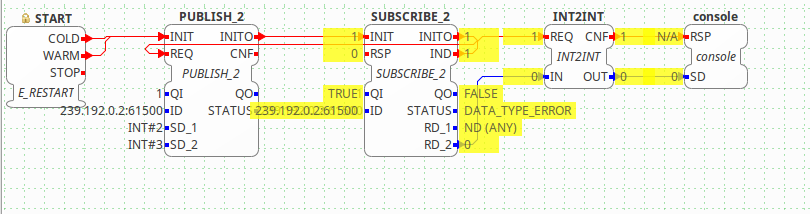

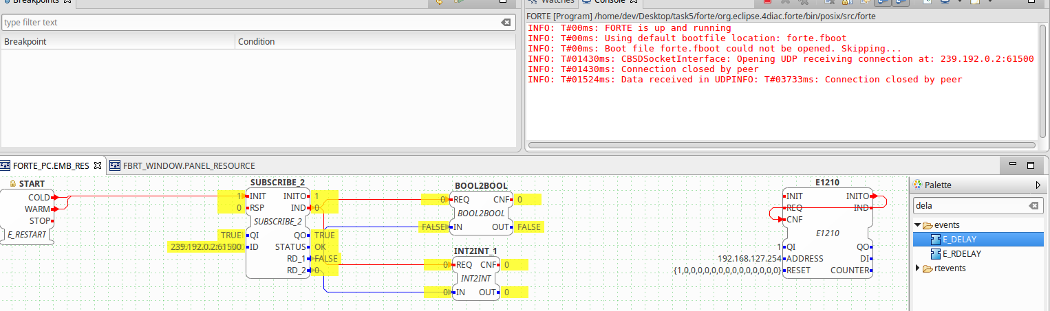

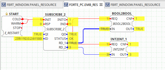

Re: SUBSCRIBE_2 and PUBLISH_2 issue [message #1791350 is a reply to message #1791349] Thu, 28 June 2018 06:02 Go to previous messageGo to next message
Thank you for your support! It works if you have PUBLISH_2 and SUBSCRIBE_2 in FORTE, as shown in the first image below. But if you have PUBLISH_2 in GUI (Figure 2) and SUBSCRIBE_2 in FORTE (Figure 3) it seems not to respond.
Agostino

Re: SUBSCRIBE_2 and PUBLISH_2 issue [message #1791365 is a reply to message #1791350] Thu, 28 June 2018 08:04 Go to previous messageGo to next message
Hi!
As you trigger both applications via E_RESTART FBs, have you made sure, that the subscriber is ready, before you send via the publisher? From your screenshots I can see, that FORTE did not receive a message.
Martin

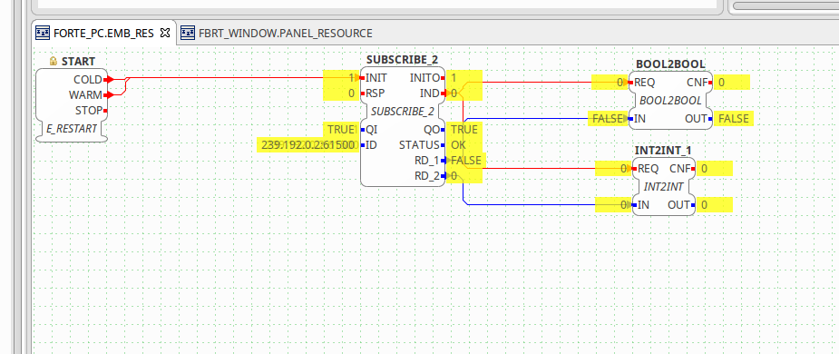

Re: SUBSCRIBE_2 and PUBLISH_2 issue [message #1791376 is a reply to message #1791365] Thu, 28 June 2018 08:47 Go to previous messageGo to next message
From the screenshot below I see that the receiving connection is open and that then something is received. Structure is the same as before.
Thank you for your time!

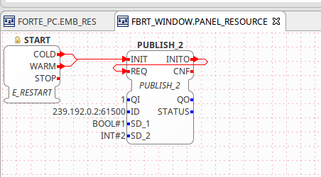

index.php/fa/33248/0/
EDIT: I have tried with a minimal GUI and PUBLISH_1 and SUBSCRIBE_1. When I click a checkbox, the value is sent. Also in that case, if PUBLISH_1 is given a constant value (like BOOL#1), it is not sent. If, instead, you connect IN_BOOL and PUBLISH_1, everything works. But I need a constant value...

Re: SUBSCRIBE_2 and PUBLISH_2 issue [message #1791379 is a reply to message #1791376] Thu, 28 June 2018 09:42 Go to previous messageGo to next message
Based on your EDIT, it seems to me, that the problem lies with the FBDK. I am not an FBDK expert, but I would assume, that it does not support typification via constants. Is there a BOOL2BOOL FB available in FBDK? If yes, try to connect it on the SD, the same holds for SD_2 but with an INT2INT respectively.
Martin

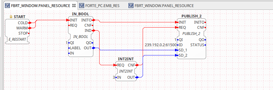

Re: SUBSCRIBE_2 and PUBLISH_2 issue [message #1791385 is a reply to message #1791379] Thu, 28 June 2018 09:56 Go to previous messageGo to next message
Thank you for your good idea!
Solution:
index.php/fa/33252/0/
index.php/fa/33253/0/
  • Attachment: 2.PNG
    (Size: 35.54KB, Downloaded 378 times)
  • Attachment: 3.PNG
    (Size: 35.75KB, Downloaded 365 times)
