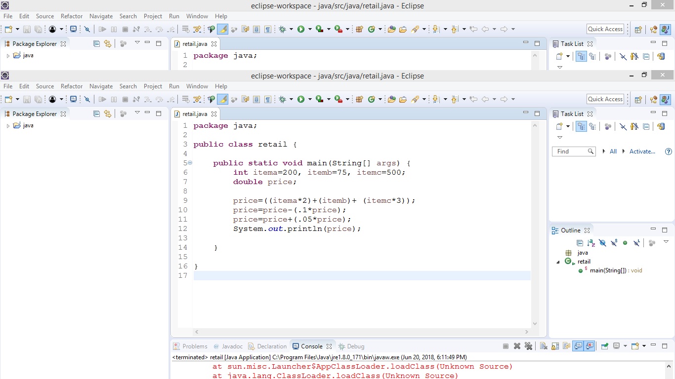

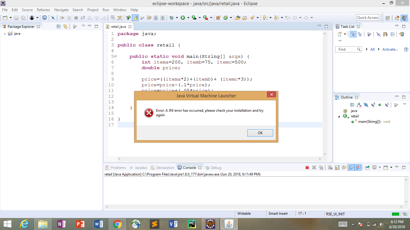

Hi, Please help me to get this error fixed. I have a lenovo 2014 laptop, I 've just downloaded the JSE version 8. Then, I downloaded eclipse.
After I inputted some codes and ran, I received errors( please refer to attachments for error message).

These are the completed error code message:
Exception in thread "main" java.lang.SecurityException: Prohibited package name: java
at java.lang.ClassLoader.preDefineClass(Unknown Source)
at java.lang.ClassLoader.defineClass(Unknown Source)
at java.security.SecureClassLoader.defineClass(Unknown Source)
at java.net.URLClassLoader.defineClass(Unknown Source)
at java.net.URLClassLoader.access$100(Unknown Source)
at java.net.URLClassLoader$1.run(Unknown Source)
at java.net.URLClassLoader.findClass(Unknown Source)
at sun.misc.Launcher$AppClassLoader.loadClass(Unknown Source)
at sun.launcher.LauncherHelper.checkAndLoadMain(Unknown Source)
Re: errors code while running java on windows after installed [message #1791099 is a reply to message #1791087] Fri, 22 June 2018 15:42 Go to previous messageGo to next message
Did you read the error message? The cause in on the first line.
Do not attempt to put your code in the package 'java'.

Re: errors code while running java on windows after installed [message #1791119 is a reply to message #1791118] Sun, 24 June 2018 01:40 Go to previous messageGo to next message
I imagine/guess if you delete the package declaration from the file itself that the file remains in the same location "/java/src/java/retail.java" but in general the package declaration's name must match the Java file's folder path relative to the source root, i.e., "/java/src" is a Java source folder and "java/retail.java" is the relative path of the Java source file. A Java file at that location must have package declaration with the name "java".
I'd suggest you delete everything under your "/java/src" folder (but not the src folder itself) and then use the context menu on the src folder to create a new class by invoking New -> Class from the context menu. In the wizard you can choose the package name (or leave it blank, which is usually not so useful except for toy examples which is why the wizard will tell you this is discouraged) and you can choose the class name (which generally should be a name that starts with an upper case letter, which the wizard will also indicate with a warning that "retail" is not a great style choice according to Java's naming conventions).
