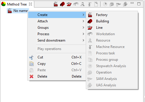

I think it is easiest described by images. This is the original context/popup menu in my part (image1).
The "Create" sub menu contains menu items that enables the user to create different types of objects. It is typically dependent on the current selection : there are underlying rules determining whether a certain handleditem should be enabled or not.

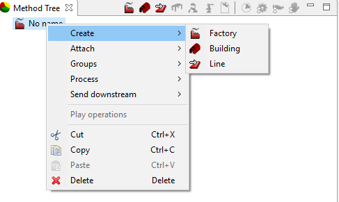

This seems to work fine at a first glance. When the same object is selected, the set of visible items are narrowed down to the following (image2).
This looks much better in my opinion - the user is presented with the enabled menu items only.

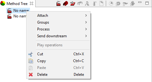

But, setting the visibility explicitly this way has major drawbacks which ultimately corrupts the context menu: when the user selects more than one object, all "Create"-handlers should in my application always be disabled. But, setting the visibility to "false" on *all* menu items below a certain menu one time will remove the very menu itself forever - it can never be made to come back again. So in the end, the context menu itself will be like in this image (image3), even if the selection is really a good one that should "produce" the create sub menu:
