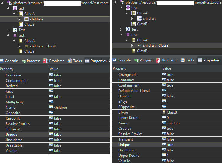

Here is a simple Xcore model:
package test
class ClassA {
    contains ClassB children
class ClassB { }
I open this model with "Reflective Xcore Model Editor" and I see 3 packages: XPackage, GenModelPackage, EPackage.
The children property is non-unique in XPackage as expected (see left part of attached picture). But this property is unique in the derived EPackage (see right part of attached picture). Why it's marked as unique?

The problem is that an Xcore model and an derived Ecore model are inconsistent. I have an Xtend-based code generator. When I generate code for an XPackage everithing works as expected. But when I execute a similar codegenerator for EPackage contained in the same resource (and derived from the XPackage) all references becomes unique. I think references must be unique or non unique in both XPackage and EPackage.
Oh, I've found a workaround: https://bugs.eclipse.org/bugs/show_bug.cgi?id=467855
@Ecore(^unique="false")
But if I can mark a reference as non-unique using the annotation, why it can't be marked automatically?..
