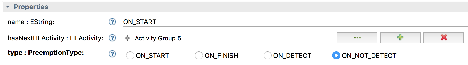

I have created successfully with Sirius a tool to create instance models for my meta-model with the desired functionality up to now. What I am failing to do right now, is to find a way to update a property X of a model element, when the user changes an attribute Y of the same model element through the Properties View.
As an example please consider the screenshot below. What should I do to update the property name, when the user changes the type property?
Thank you in advance for any help and hints.
Christoforos
Re: Updating model element properties with Sirius. [message #1787444 is a reply to message #1787430] Fri, 25 May 2018 09:01 Go to previous message
You need to change the begin operation to do what you need.
Please find attached a simple example. When you click on the checkbox Abstract, "_abstract" or "_notAbstract" is added at the end of the class name.
Laurent
