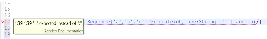

I copy and paste your code exactly but it gives some errors .
would you please give a me link of where i can find an example about using Iterate ?

Apologies, I tested it in the Interactive Xtext OCL Console (that users the Xtext-based parser which matches up arguments to iterators to avoid hardwiring the iterator syntaxes in the grammar). This tolerates a typo; for iterate the result/accumultor should be preceded by a ";" rather than a ",". The OCL Console using the old LPG-based parser gives a similar error to what you see. The following works in both:
Evaluating:
Sequence{'a','b','c'}->iterate(ch; acc:String ='' | acc+ch)
Results:
'abc'
There are very adequate examples in "7.6.6 Iterate Operation" of the OCL specification. Warm&Kleppe providers a useful section too but withy the dsame typo as my original solution.
