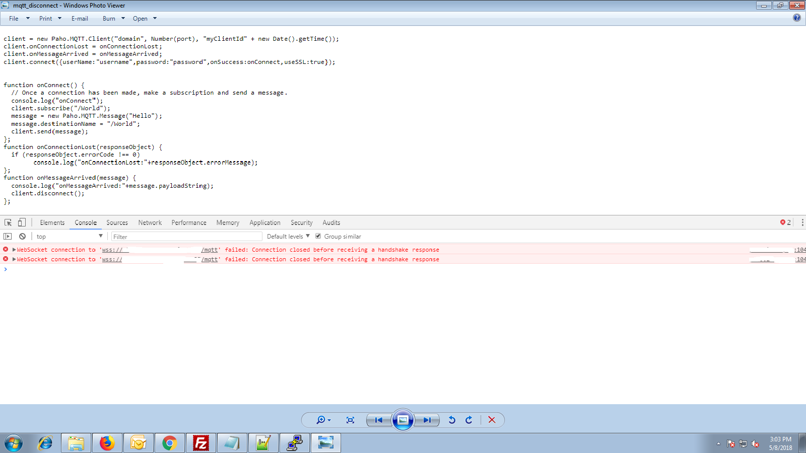

We are getting below error in some browsers(chrome or mozilla) when we connect mqtt using web sockets. When we clear browser history then connected.
Error:
WebSocket connection to 'wss://host:port/mqtt' failed: Connection closed before receiving a handshake response Paho.MQTT.ClientImpl._doConnect @ mqttws31.js:979
My connection:
var client = new Paho.MQTT.Client("host", Number(port), "myClientId" + new Date().getTime());
client.connect({userName:username,password:password,onSuccess:onConnect,onFailure:doFail,useSSL:true,cleanSession:false});
So please look into this.

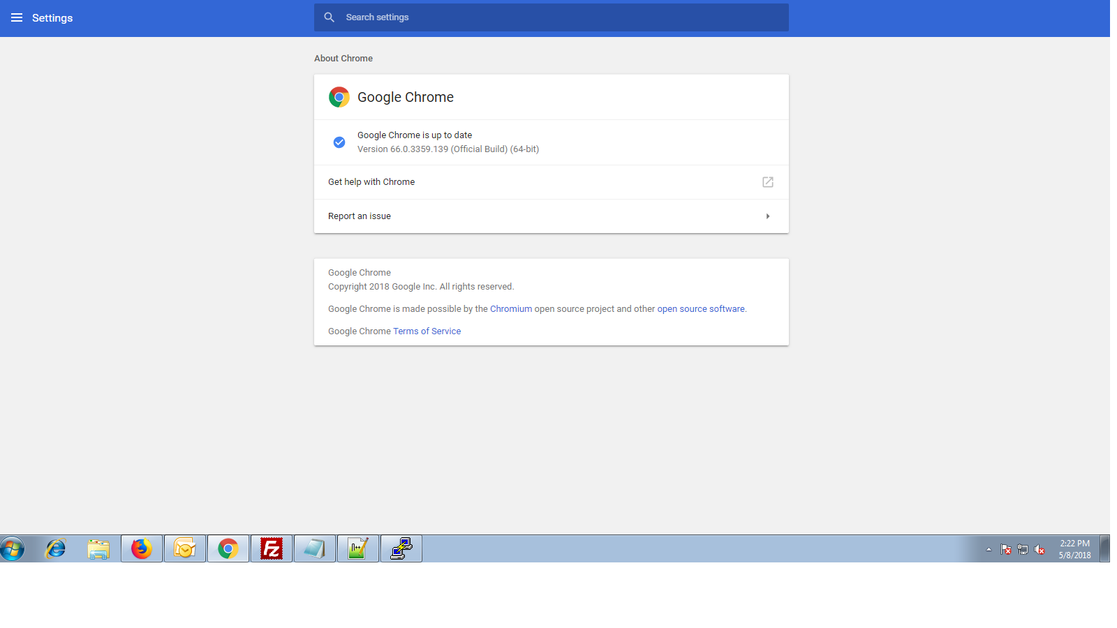

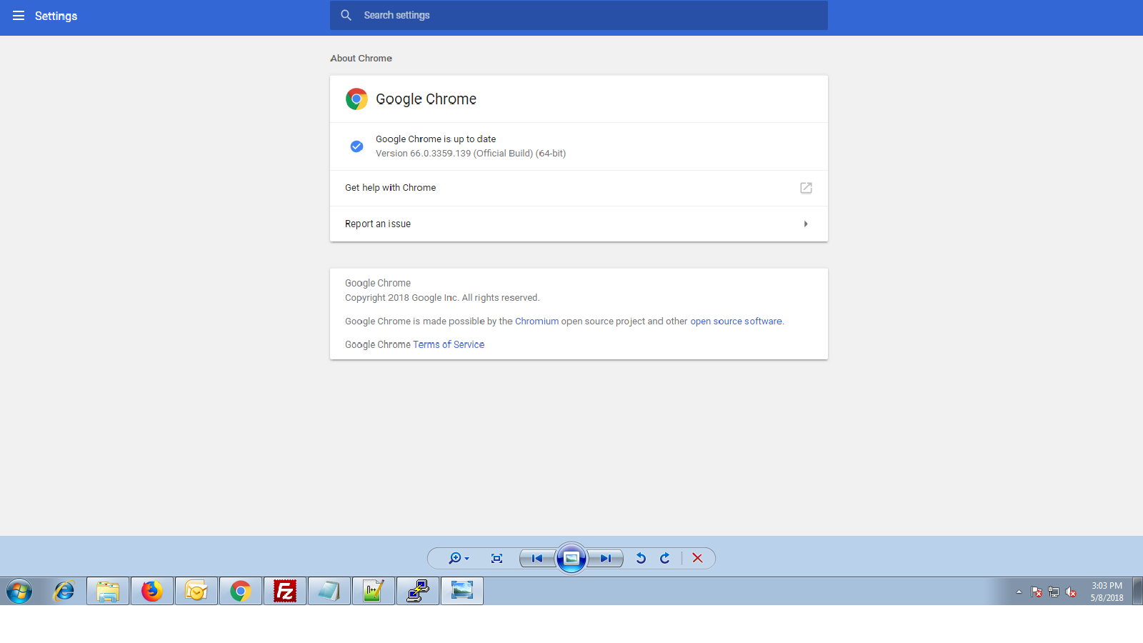

Hi James,
Please check screen shots of chrome versions and response code of different systems, one system got error and another one connected succesfully.
