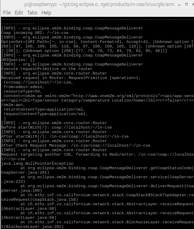

I tried to send CoAP message to IN-CSE. but IN-CSE printed NullpointerException like the picture i uploaded. I don't know why error appeared...
the source code i uploaded is the sample application to send CoAP message using Californium. this is made by Klemen Petrovcic. how to send the message successfully?

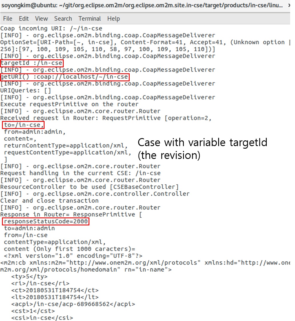

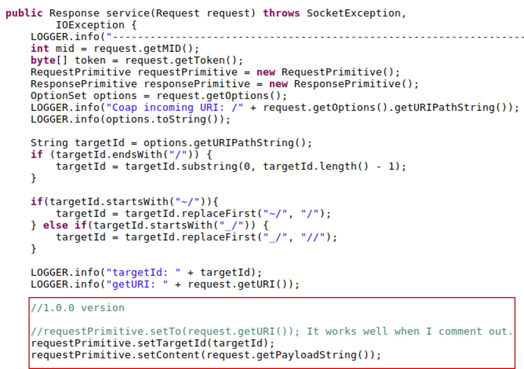

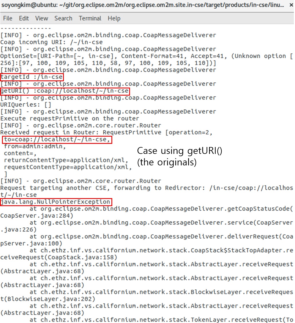

First, I checked the OM2M version released. and I tried to send CoAP message to old version(1.0.0). then It was transferred well without problem. but the latest version had an error. So I compared the two codes.( I focused on CoapServer.java in org.eclipse.om2m.binding.coap)

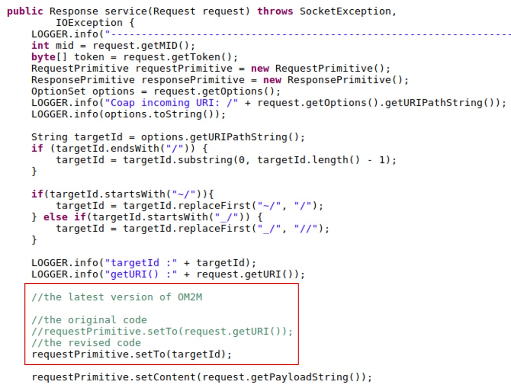

In Coapserver.java, service() create a requestPrimitive object and transfer to Router.java. and It uses the targetId as a "to" variable in the requestPrimitive object via setTargetId() (setTargetId() calls setTo()) in 1.0.0 version. but In the latest version, it uses the string returned getURI() as a "to" variable in the requestPrimitive object.
(and in the latest version it does not seem to use targetId unless I use it.)
targetId contained "/in-cse" and getURI() returned "coap://localhost/~/in-cse".
The lastest version removed setTargetId() in reqeustPrimitive class. so when I modified setTo(getURI()) to setTo(targetId), it was transferred well.
Is this the bug of the lastest version? or am I doing something wrong?
