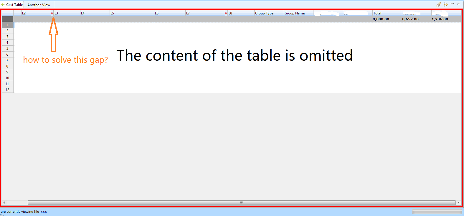

GAP between the custom image and base content with background image [message #1785750] Thu, 19 April 2018 06:47 Go to next message
Experts.
I'm try to add an image to a cell which has background image. But there is a gap between the custom image and the cell's original content. (see my attachment)
my configuration code is :
public class ColumnHeaderStyleWithRedStarConfigurations extends DefaultColumnHeaderStyleConfiguration {
    private String columnWithRedStarLabel;
    public static final Image RED_STAR_ICON_IMAGE = GUIHelper.getImageByURL(Images.getURL(Images.COLUMN_HEADER_BACKGROUND_IMAGE_WITH_RED_STAR));
    public static final Image COLUMN_HEADER_BACKGROUND_ICON_IMAGE = GUIHelper.getImageByURL(Images.getURL(Images.COLUMN_HEADER_BACKGROUND_IMAGE));
    public ColumnHeaderStyleWithRedStarConfigurations(String columnWithRedStarLabel) {
        this.columnWithRedStarLabel = columnWithRedStarLabel;
    public void configureRegistry(IConfigRegistry configRegistry) {
        Style cellStyle = new Style();
        cellStyle.setAttributeValue(CellStyleAttributes.HORIZONTAL_ALIGNMENT, HorizontalAlignmentEnum.LEFT);
        configRegistry.registerConfigAttribute(CellConfigAttributes.CELL_STYLE, cellStyle, DisplayMode.NORMAL, columnWithRedStarLabel);
        configRegistry.registerConfigAttribute(CellConfigAttributes.CELL_STYLE, cellStyle, DisplayMode.SELECT, columnWithRedStarLabel);
        configRegistry.registerConfigAttribute(CellConfigAttributes.CELL_PAINTER, getCellPainterDecorator(), DisplayMode.NORMAL, columnWithRedStarLabel);
        configRegistry.registerConfigAttribute(CellConfigAttributes.CELL_PAINTER, getCellPainterDecorator(), DisplayMode.SELECT, columnWithRedStarLabel);
    private CellPainterDecorator getCellPainterDecorator() {
           /* try 1 */
        return new CellPainterDecorator(new BackgroundImagePainter(new TextPainter(true, false, false), COLUMN_HEADER_BACKGROUND_ICON_IMAGE), CellEdgeEnum.LEFT, new ImagePainter(RED_STAR_ICON_IMAGE));
        /* try 2 */
//        return new CellPainterDecorator(new ScalingBackgroundImagePainter(new TextPainter(true, false, false), COLUMN_HEADER_BACKGROUND_ICON_IMAGE,
//                ISSPTheme.COLOMN_HEADER_BACKGROUND_IMAGE), CellEdgeEnum.LEFT, new ImagePainter(RED_STAR_ICON_IMAGE));
        /* try 3 */
        // return new CellPainterDecorator(new TextPainter(true, false, false), CellEdgeEnum.LEFT, new ImagePainter(RED_STAR_ICON_IMAGE));
I added the configuration to my NatTable instance:
natTable.addConfiguration(new ColumnHeaderStyleWithRedStarConfigurations(COLUMN_WITH_RED_STAR_LABEL));
I've added the label COLUMN_WITH_RED_STAR_LABEL for the columns I want,
see code :
 private void updateColumnNames() {
        Set<Integer> filterIndexes = selectedFilterValues.keySet();
       ColumnOverrideLabelAccumulator labelAccumulator = new ColumnOverrideLabelAccumulator(costTable.getColumnHeaderLayer());
        for (int i = 0; i < costTable.getColumns().size(); i++) {
            String colname = costTable.getColumns().get(i).getColumnName();
            if (NAME_OF_TOTAL_COLUMN.equals(colname)) {
                break;
            Column col = costTable.getColumns().get(i);
            boolean hasStar = col.getColumnName().startsWith(StringUtils.SPACE); // placeholder "space" with the column means that the column is filtered
            boolean filteredCol = filterIndexes.contains(i);
            if (hasStar && !filteredCol) {
                costTable.getColumns().get(i).setColumnName(colname.substring(1)); // remove the "space"
            } else if (!hasStar && filteredCol) {
                col.setColumnName(StringUtils.SPACE + colname); // add the "space"
               labelAccumulator.registerColumnOverridesOnTop(i, COLUMN_WITH_RED_STAR_LABEL);
        costTable.getColumnHeaderLayer().setConfigLabelAccumulator(labelAccumulator);
        costTable.refreshColumnLabels();
        costTable.refreshData();
Is there a way to solve this problem? Or would you please give some advice?
Thanks in advance.
Re: GAP between the custom image and base content with background image [message #1785753 is a reply to message #1785750] Thu, 19 April 2018 06:57 Go to previous messageGo to next message
The CellPainterDecorator also has a paintBackground configuration. Because of backwards compatibility it is set to true by default.
You can either use a constructor with all parameters or (my suggestion) use CellPainterDecorator#setPaintBackground(false) to avoid rendering the background which is causing the gap, by still using the simple constructor.
Re: GAP between the custom image and base content with background image [message #1785792 is a reply to message #1785753] Thu, 19 April 2018 22:50 Go to previous messageGo to next message
It worked after I change my code like this:
                ISSPTheme.COLOMN_HEADER_BACKGROUND_IMAGE), CellEdgeEnum.LEFT, 0, new ImagePainter(RED_STAR_ICON_IMAGE), true, false);
The root cause is that for the constructor I used before there are 2 pixels as spacing between base and decoration painter. So, for my scenario, it should be 0.
Dirk, Thank you very much for your help.
