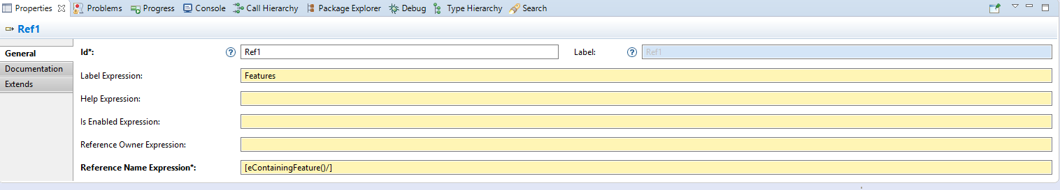

Minimal exemple:
index.php/fa/32622/0/
Reference name expression must be an EReference name available on the semantic element behind the selection. Not an AQL expression or other interpreter.
Label expression is any string you want.
Look at your error log to see if you have not an error message when your diagram is opened and your graphic element selected with properties view visible.

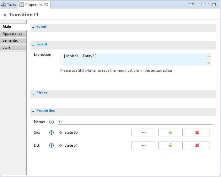

Hi Charles,
Thanks for the hint. I have tried different settings for "Reference Name Expression" such as var:self , eContainer and etc...
index.php/fa/32640/0/
What I see is the following. It shows the Group section which is "Event", but it does not show the actual reference widget. Nothing is shown in the Event section as you can see... I don't know what else should I do. It seemed to be very straight forward but not sure where I'm doing wrong. Any help would be appreciated. I also don't see any relevant errors. There is only one error when I run validate command on the widget, but I'm not sure if is really the root cause "Invalid Type: org::eclipse.sirius.properties.core.api.SiriusInputDescriptor"

If nothing is shown it means either the reference name point at something that is not an EReference. eContainer is an EOperation so it will not work.
Or the semantic element behind the selected graphic element does not contains any reference with given name.
Or no object are pointed by the ereference on selected element.
Look at ecore metamodel if you want to know what is an EReference and what is not for ecore metamodel.

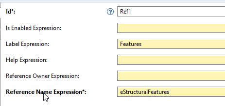

Try eStructuralFeatures and select an EClass containing an EAttribute in your diagram. Then you should see the widget.

Re: issue with the Reference widget in the properties view [message #1785776 is a reply to message #1785743] Thu, 19 April 2018 10:54 Go to previous messageGo to next message
Thanks a lot Pierre. It works now :)
