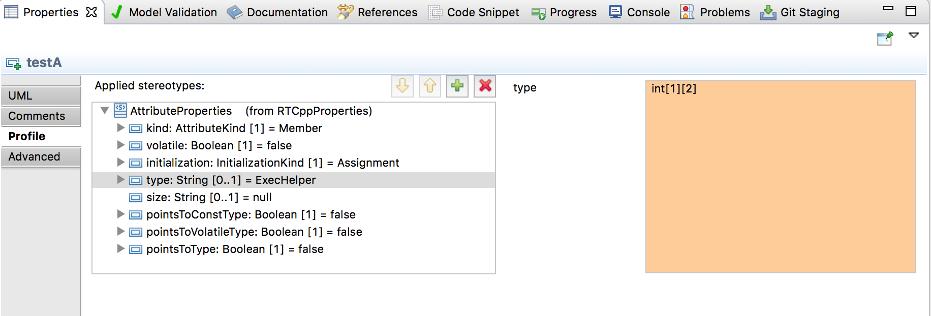

I think the best way is to apply the AttributeProperties stereotype and then set the type. Please see the below screenshot.
index.php/fa/32367/0/

Doesn't quite work for me though. I get the following compile error:
error: expected unqualified-id before '[' token
int[2][10]

I'm afraid that in C++ the syntax is
type name[size1][size2]...[sizeN];
so
int[3][2] attr;
is a C++ syntax error.
Unfortunately using the AttributeProperties.type property won't be much help here, as the code generator simply puts whatever is in this 'type' property before the attribute name in the generated code.
As a workaround, you could use the 'privateDeclarations', 'protectedDeclarations' or 'publicDeclarations' properties of the CapsuleProperties stereotype, or the PassiveClassProperties stereotype, to add any C++ declaration.
However, it would probably be better to create a suitable abstraction for the multi-dimentional array: define a class called e.g. My2DArray, which provides suitable setters and getters (in C++ you can define them as operators so that they look primitive), and internally it can use the '*Declarations' properties mentioned above, or some alternative representation, like an array of lists for a sparse array.

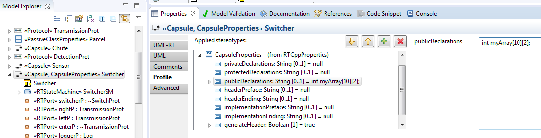

Ok, I think I get it: Suppose you want capsule 'C' to contain an attribute 'int myArray[5][5]':
1) select the capsule 'C' and the 'Properties' tab
2) ensure that stereotype 'CapsuleProperties' has been applied (if not, click the green '+', select 'CapsuleProperties' on left, click '->', and then 'Ok')
3) expand 'CapsuleProperties', select property 'privateDeclarations' (or, 'protectedDeclarations', or 'publicDeclarations'), and input 'int myArray[5][5];' in text field on right (see attached screen shot).
Now, 'myArray' should be visible and usable in the action code of capsule 'C', e.g., you should be able to write:
myArray[0][0] = 0;
loggerP.log("[Switcher] myArray[0][0] = %d", myArray[0][0]);
in the action code of any transition of the state machine of 'C'.
While this should work, the not-so-nice thing is that the 'myArray' attribute
is 'hidden', i.e., it is not directly listed as an attribute of capsule 'C' in the
Model Explorer, meaning that (1) one may forget or not realize it is there, and
that (2) it is cumbersome to look up, e.g., the precise name or dimensions, etc
To avoid this, wrap the array into a passive class, e.g., 'MyArray' that holds the
array and offers the required access methods.
To create this passive class, right-click 'C', then 'New UML-RT Child', then 'Class'.
Call that class 'MyArray', and apply the 'PassiveClassProperties' stereotype. Use
the 'privateDeclarations' property as before to create the array. Then, define
the desired operations for the class (right-click 'MyArray', select 'New UML-RT Child',
then 'Operation', and then use the 'Properties | UML' and the 'Code Snippet' tabs).
Thanks everybody!
Juergen
