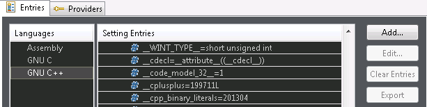

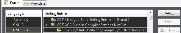

MinGW GCC Built-ins
Note that __cplusplus is defined as 199711L by MinGW GCC
index.php/fa/32201/0/
index.php/fa/32202/0/

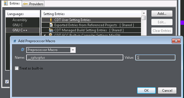

Adding a macro definition
index.php/fa/32203/0/
Be sure to select the proper configuration name when you do this.
